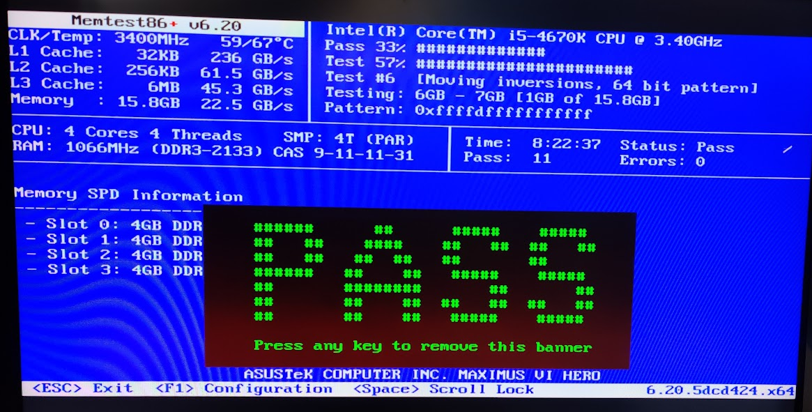

Have you done memtest?
No, buy I ought to, really. I didn't think about running it so I'm going to do that right now!
Edit:
It passed the first tests but I'm going to let it run all night.
Edit 2: More than 8 hours later, 11 test passed, I'm willing to call them good.
