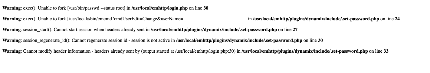

I can't even access the webgui , it wants a new pass, and when I set it :
385840495_Screenshot2024-01-27at16_38_43.thumb.png.ca1646821c6334eaf154c82c332b1f4f.png
The OS is in RAM. When you boot, the OS is unpacked fresh from archives on the flash drive, into RAM, and it runs completely in RAM. Think of it as firmware. So when you reboot, all of that goes back exactly as it was.
/bin, /usr, ... these are all OS folders.
If you have done something to these folders, all sorts of things can go wrong since these folders are the OS. And since they are reloaded into RAM at boot, rebooting should put all that back just as it was when that version of the OS was released.
But you need to figure out how you are breaking it. You probably have some docker container with a host path mapped to / which is the root folder where all the OS folders are.
