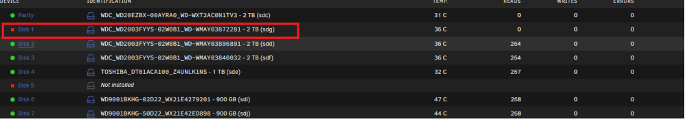

i have one drive that became to small so i replace it by a new on that a bit biger but we have faced a power outage so when the serveur reboot i have now 2 drive that is not in ok state.
so my question i how can i reanable the drive with the red rectangle to do may data rebuilt because the data is on the drive.
could you please help me to prevent any data lose?
You can try this:
-Tools -> New Config -> Retain current configuration: All -> Apply
-Check all assignments and assign any missing disk(s) if needed, including the new disk5, replacement disk should be same size or larger than the old one
-IMPORTANT - Check both "parity is already valid" and "maintenance mode" and start the array (note that the GUI will still show that data on parity disk(s) will be overwritten, this is normal as it doesn't account for the checkbox, but it won't be as long as it's checked)
-Stop array
-Unassign disk5
-Start array (in normal mode now) and post new diags
the drive is showing now so i think i can add the new drive to replace it?
If the emulated disk is now mounting and contents look correct you can rebuild.
