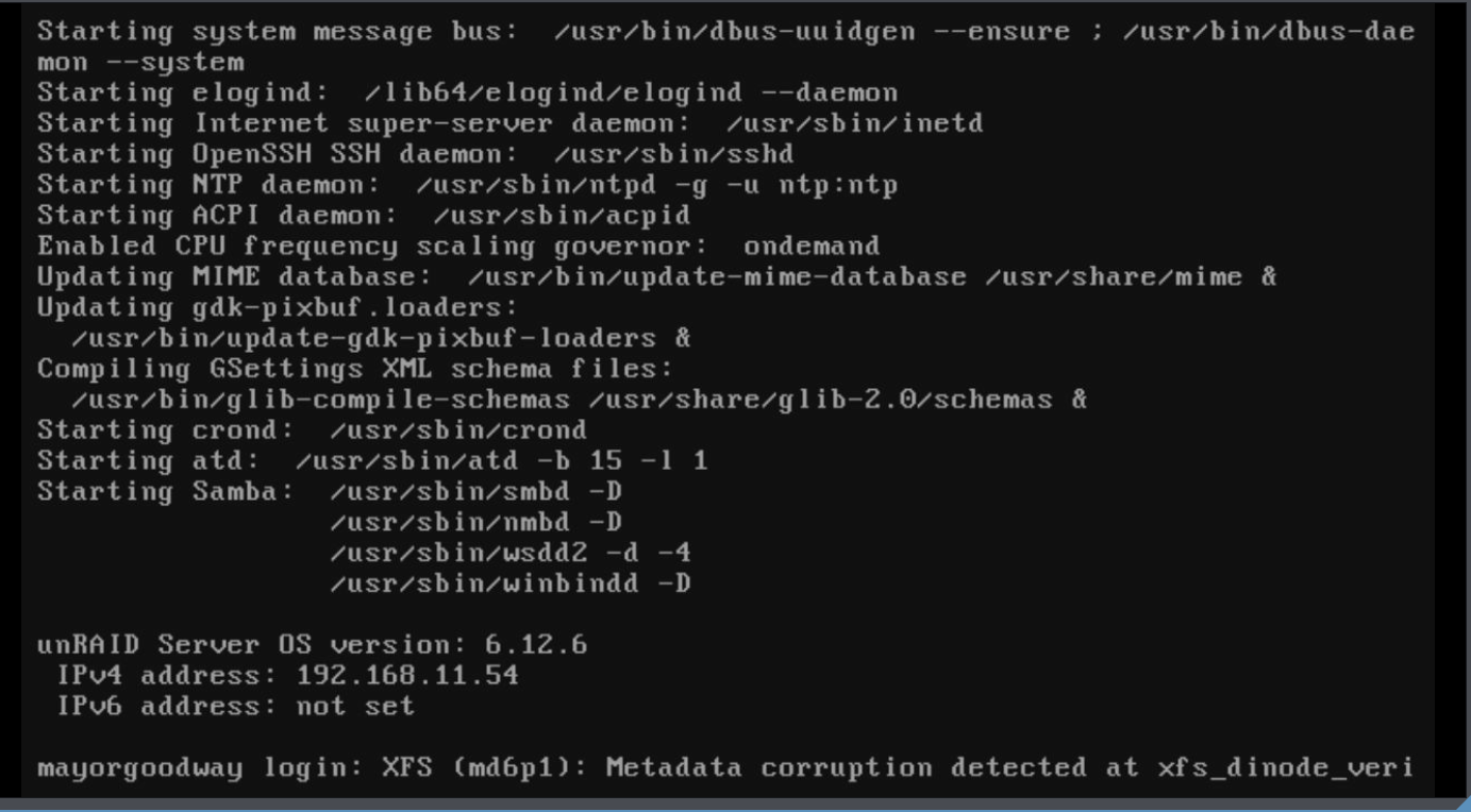

XFS metadata corruption detected xfs_dinode_veri...
Had a the server hard crash, and I just wanted to make sure I was on the right track here:

thanks for getting back JorgeB. Ran that, didn't see any smoking guns:
Spoiler
Phase 1 - find and verify superblock...
Phase 2 - using internal log
        - zero log...
        - scan filesystem freespace and inode maps...
        - found root inode chunk
Phase 3 - for each AG...
        - scan and clear agi unlinked lists...
        - process known inodes and perform inode discovery...
        - agno = 0
        - agno = 1
        - agno = 2
        - agno = 3
        - agno = 4
        - agno = 5
        - agno = 6
        - agno = 7
        - agno = 8
        - agno = 9
        - agno = 10
        - agno = 11
        - agno = 12
        - process newly discovered inodes...
Phase 4 - check for duplicate blocks...
        - setting up duplicate extent list...
        - check for inodes claiming duplicate blocks...
        - agno = 0
        - agno = 3
        - agno = 1
        - agno = 4
        - agno = 5
        - agno = 7
        - agno = 8
        - agno = 6
        - agno = 9
        - agno = 11
        - agno = 10
        - agno = 2
        - agno = 12
Phase 5 - rebuild AG headers and trees...
        - reset superblock...
Phase 6 - check inode connectivity...
        - resetting contents of realtime bitmap and summary inodes
        - traversing filesystem ...
        - traversal finished ...
        - moving disconnected inodes to lost+found ...
Phase 7 - verify and correct link counts...
done
That should have cleared the corrupt metadata on disk6 that was mentioned at the end of your screenshot.    When you start the array in normal mode does the drive mount OK.
