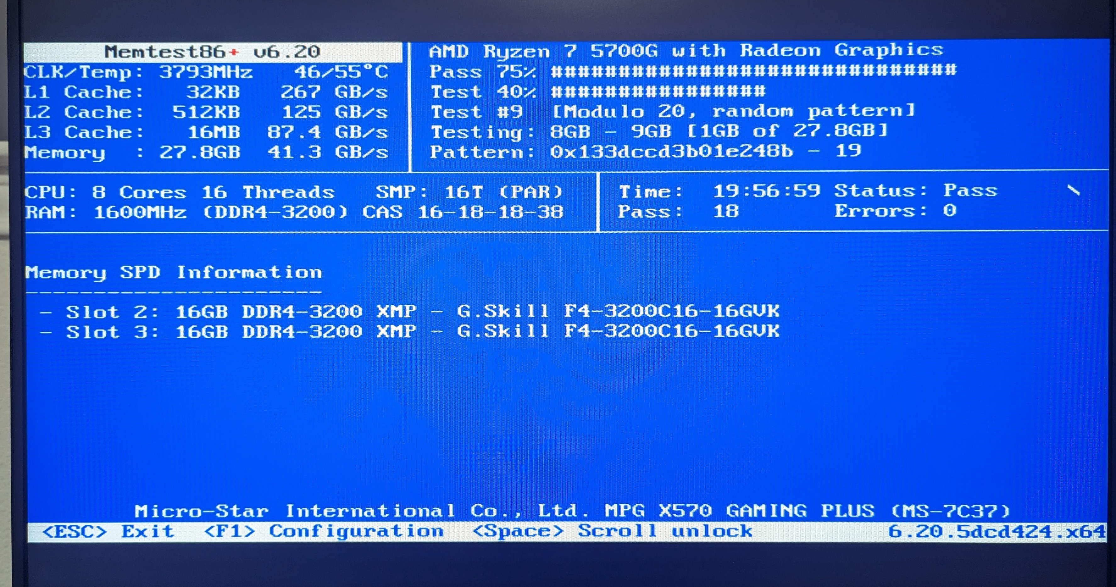

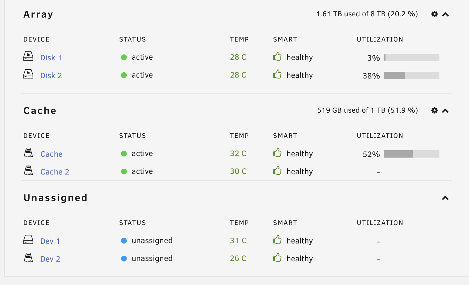

- I also ran a memtest86+ for 20 hours and found 0 errors
