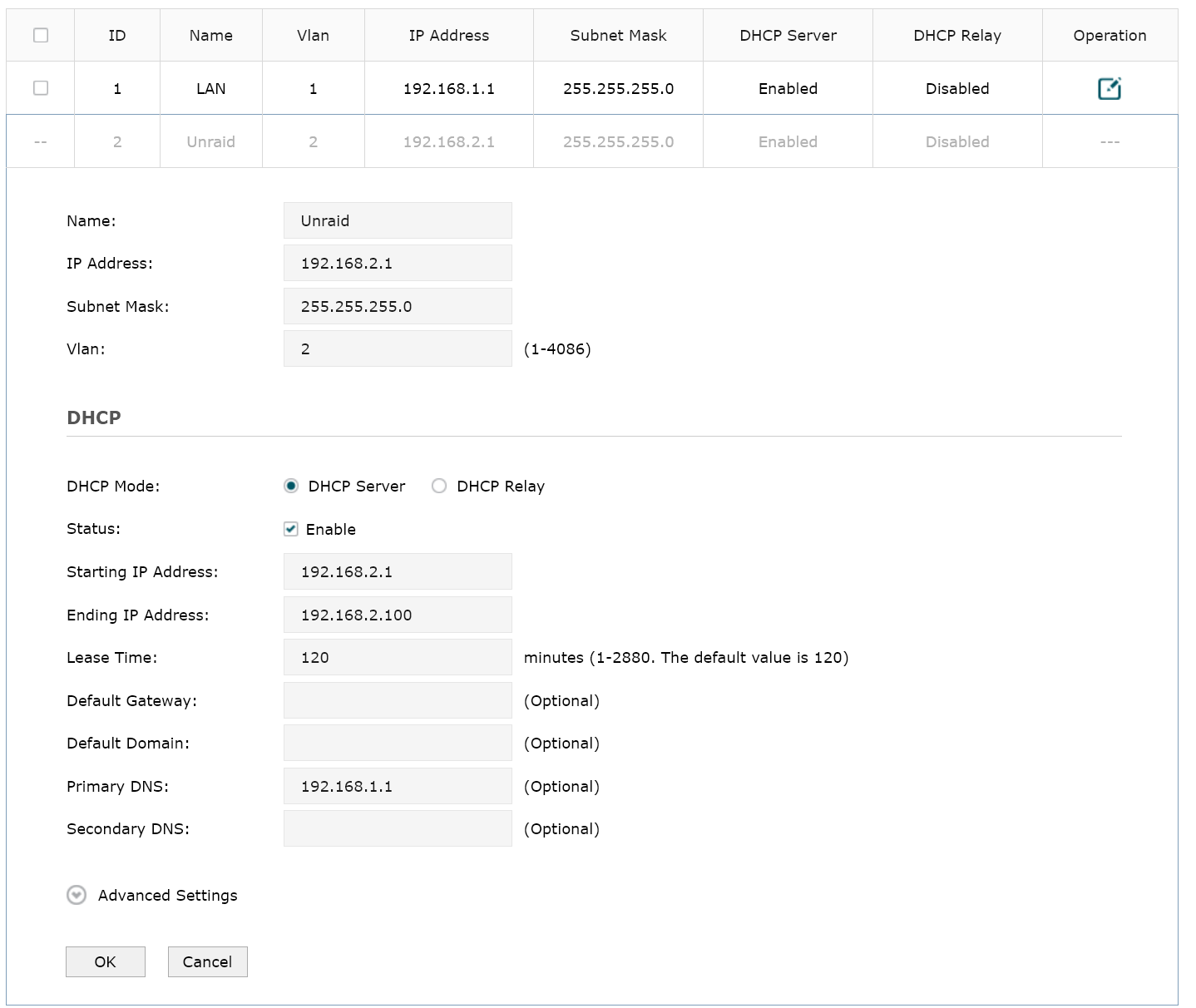

The fixed IP you had assigned earlier was not on the same subnet as your router.
Here is my Router config - Any tips to use static and 192.168.2.3 ?
Edited by fschris
Clarity
You need to either set Unraid to an address on the 192.168.1.x network or set a gateway on the 192.168.2.x network.
Thanks - I ended up using DHCP and reserving the IP in my router... Appreciate the help everyone.
