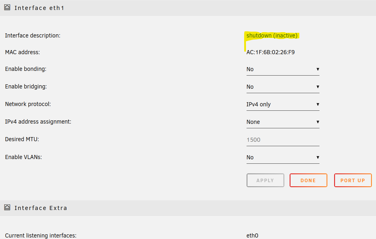

Honestly, I'm not sure how that's even possible. At the time I took that first set no LAN cable was attached (eth1 has never been used up until now), and network settings showed as follows:
However, just in case, I've attached the diagnostics file I took this morning.
server-diagnostics-20240221-0921.zip
It's normal for the NIC to be inactive unless it has an IP assigned or is part of a bond.

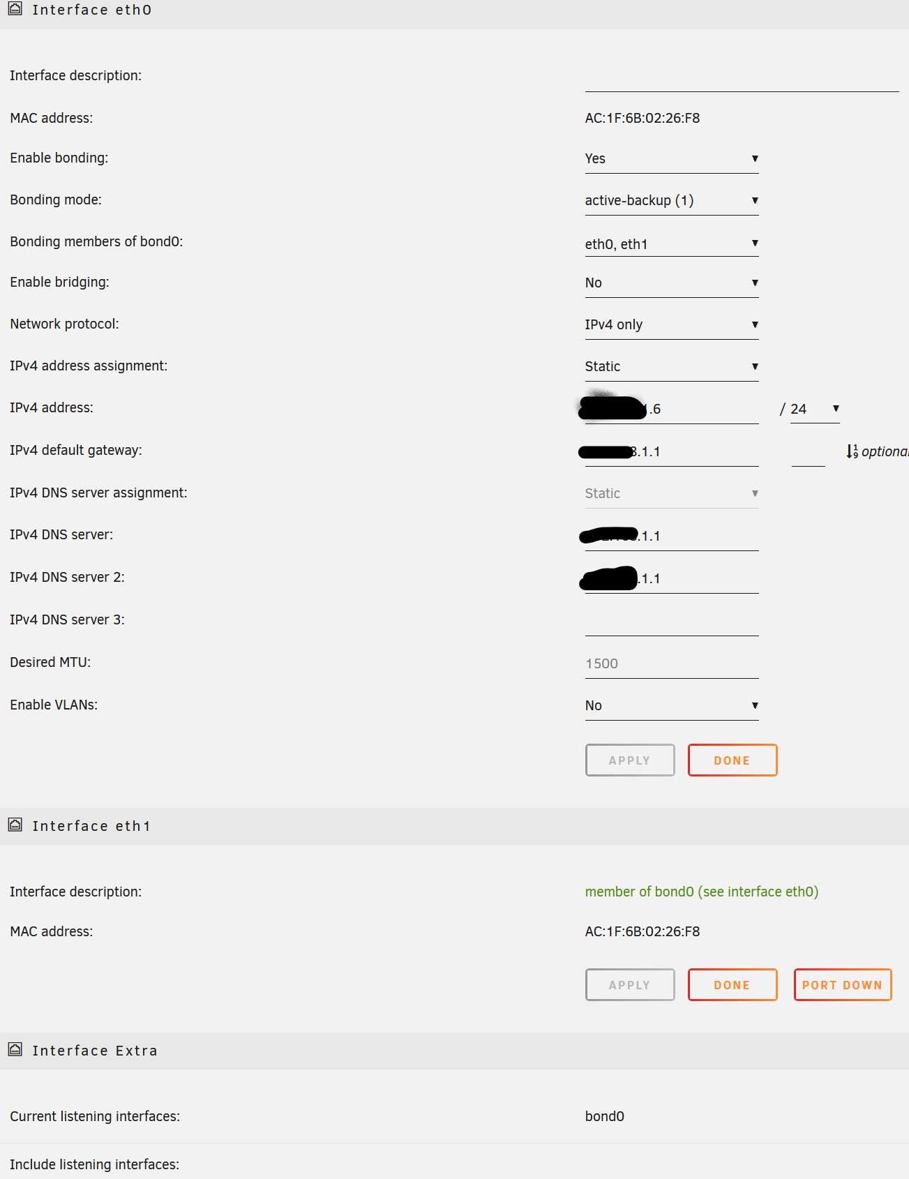

Settings - Network Settings - Enable Bonding = yes
then choose eth0 and eth1 as bond members
This is what it looks like after making this change. Are there any further settings I need to change?
To create a bond with both NICs that's it.
Thanks for confirming.
I tried doing the file transfer from my PC again with both LAN ports bonded. The failed file transfer was the original reason I started this post. Unfortunately, the file transfer paused twice after which it failed again...
Any thoughts as to where to look next?

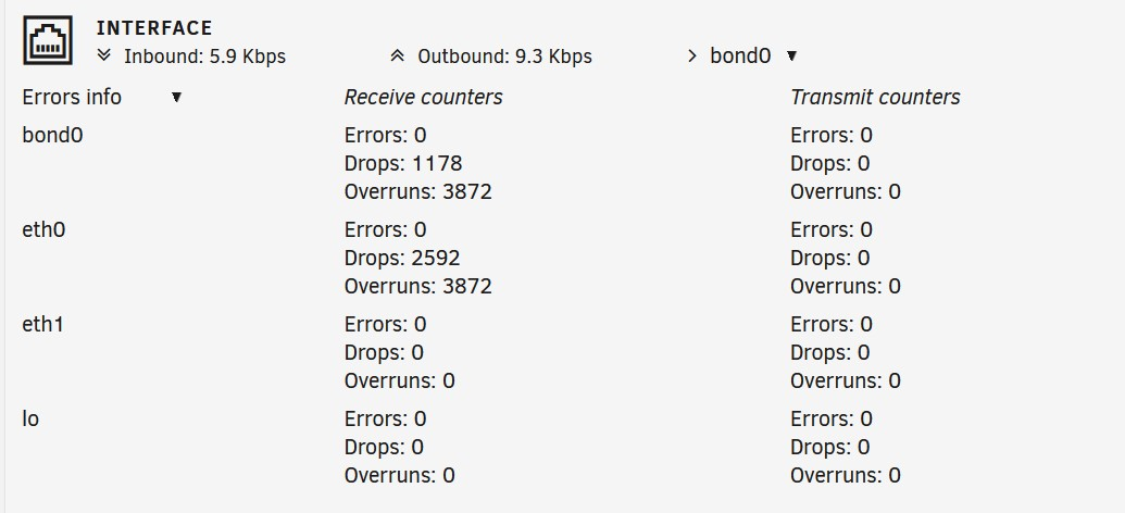

Go to the Dashboard and look at the network area.  Select errors info and see if there are any network errors.  Also see if your switch shows any network errors.

I went to the Dashboard to view network errors. This is before doing anything else here's what I found...
My switch is a 16 port unmanaged switch, so there's no interface with which to see network errors.
Then I enabled bridging in unRAID, and tried a file transfer again. There were a couple of "slowdowns", but I think this is normal behavior because I don't use a cache drive. Also, a "slowdown" behaves differently in that I can still see the Windows file transfer speed constantly changing. During what I'm calling a "pause" the Windows file transfer speed freezes - showing whatever the speed value was prior to the pause. This time I thought to capture a screenshot of the file transfer during the pause....
Just FWIW, it may also be worth mentioning that during a file transfer "pause" condition, in the unRAID main window I see the number in the Writes column for both the destination drive and the parity drive continue to climb. The numbers cease to climb when the network error message is displayed.
Finally, a screenshot of the network errors from the unRAID dashboard taken straight after the above file transfer failure...
Hopefully there's some clue here into what might be causing the issue.
That's too many drops and overruns on eth0.  Is your motherboard fairly new?
