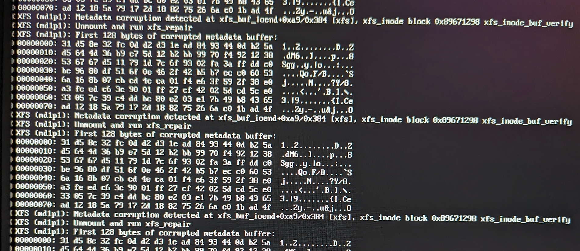

Lost some data.... I think. Maybe its something else?
I had a disk become disabled so I did the procedure to remove it from the array and add it back.  SMART data was good.  I rebooted the server and saw the screenshot I have attached.  So I removed the offending drive again, rebooted, and did an XFS_repair while the disk was out of the array.
I left the drive out and am going to purchase a replacement drive, just to have a spare.  I then noticed a lot of data missing.  I see a lot of data in my lost+found.  It seems like my emulated data must have been wrong.  I'm not sure.  Files and folders I've added for the past month or so seem to be missing data.  Maybe I have BTRFS issues?  I hope??
hyde-diagnostics-20240127-2321.zip
Looks like disk1 is still missing/emulated. Are you looking at the contents of physical disk1? Or are you looking at the contents of the emulated disk1? Physical disk1 will not have any files written while the disk was emulated.
Don't see what BTRFS has to do with it, cache is the only btrfs
Trurl... thannks for the responses.  Unfortunately, I think I screwed up at step 4.  The instructions don't say explicitly say "allow the array to rebuild"...  I stopped it at like .3% and moved on to step 4.  So I think I'm hosed.  Oddly, Plex hasn't reflected some of these files being removed.  Normally, as soon as the file system is changed, it reflects it.
Any options for me or am I out of luck?  I don't see the missing files in emulated or on the mounted, non-member data disk.
