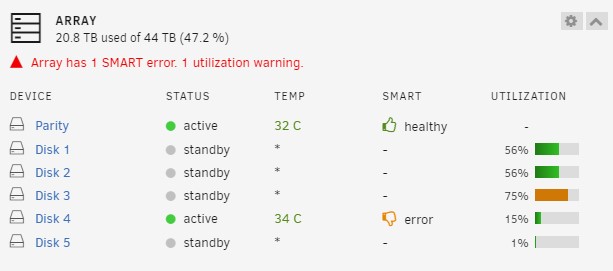

I had this error show up yesterday whilst I was transferring files to my Unraid server. One transfer was being done using the upload function in
Dynamix File Manager and the other was using Windows, both transfers were being done at the same time and the files were exactly the same as I noticed Dynamix File Manager was a lot slower (they were being uploaded to different locations).
I received this error udma crc error count is 1 ST8000NE001-2M7101_WKD2JTVD (sdf) does this mean that the drive is failing and needs replacing?
In the screenshot attached is says the drive has an error...
Thanks
Solved by Frank1940
No.  A UDMA error is  a communication error between the drive and the MB.
The connection is serial data transmission and it has a CRC check code embedded.  The error message indicates that the transmitted CRC code did not match the code calculated by the receiving device.  The data block is then re-transmitted until the codes match.  So there is no hard error that would result in data loss!
Most of the time (when there are hundreds of errors in a very short period of time), replacement of the SATA data cable with checks to make sure that the SATA connectors are fully seated is the standard procedure.   In your case, you can click on that error icon (can't remember if it is right-or-left click) and acknowledge the error.  You will be notified if it happens again.   (I had one disk with 1823  CRC errors on it for over two years and the count never increased after that initial burst.  I did replace it when I needed more storage space a few months ago.)
Oh that's great! Thanks for confirming. I haven't had any other errors since that one yesterday.
I will check the SATA connector although I haven't opened the machine for a few months so I don't think it would be that unless they can come loose over time?
Thanks again :)
