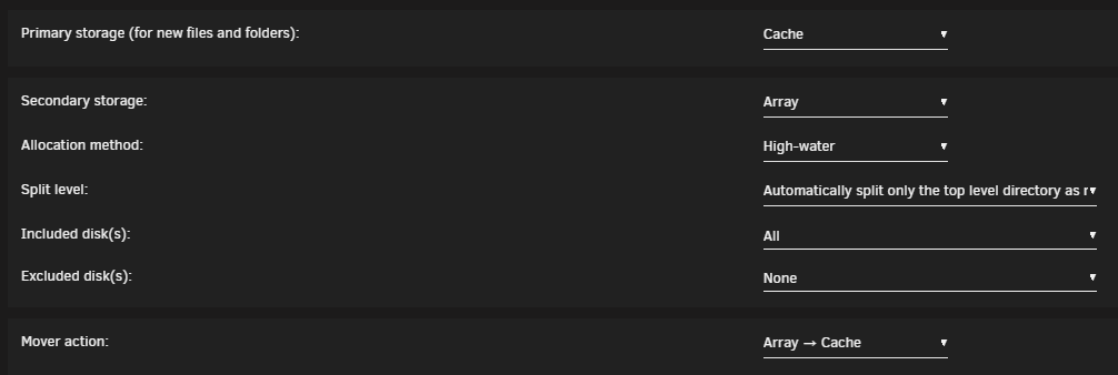

I have checked the settings of 'system' share:
Thought it looks good. Should I set secondary storage to none, or change anything here?

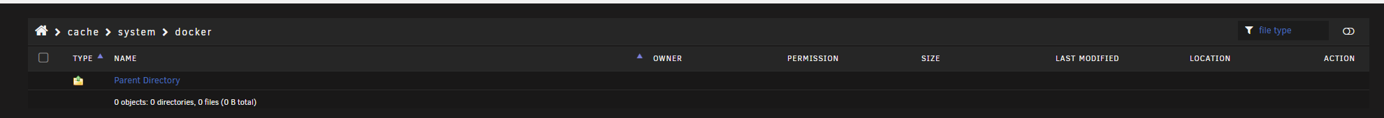

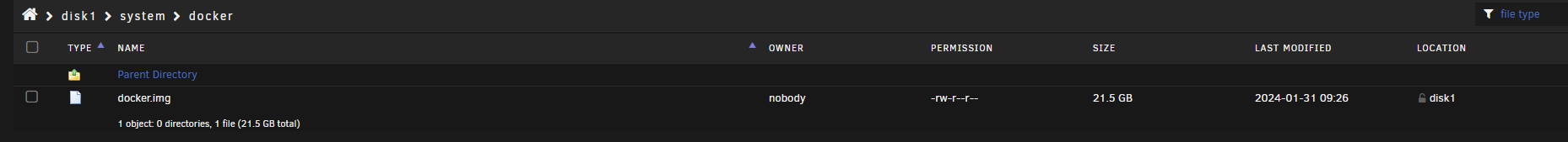

Indeed theres a docker.img file on disk1:
And same location is empty on cache:
How can I safely move it now from Disk1 to Cache?

You should:
  • Disable the Docker service under settings (it needs to be disabled to stop it keeping files open)
  • Run mover to transfer the contents of the 'system' share to the cache
  • (optional) When that completes you might want to confirm that there is now no sign of the 'system' share on disk1
  • Set the secondary storage option for the 'system' to None
  • Enable the option to use Exclusive shares under Settings->Global Share settings to get the performance advantage of bypassing the Unraid Fuse layer
  • Reenable the Docker service
Once this is done then docker will not be keeping disk1 and parity spun up all the time.

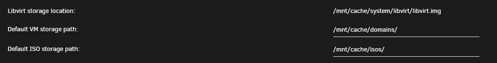

During cleanup process I have realized that in VM Manager and Docker service itself I still had paths pointing to /mnt/user instead /mnt/cache.
I have changed that as well to avoid similar issue in the future with vms:
Other than that I have made all mentioned changes and it works now :)
This is not necessary if the share is an Exclusive share.
