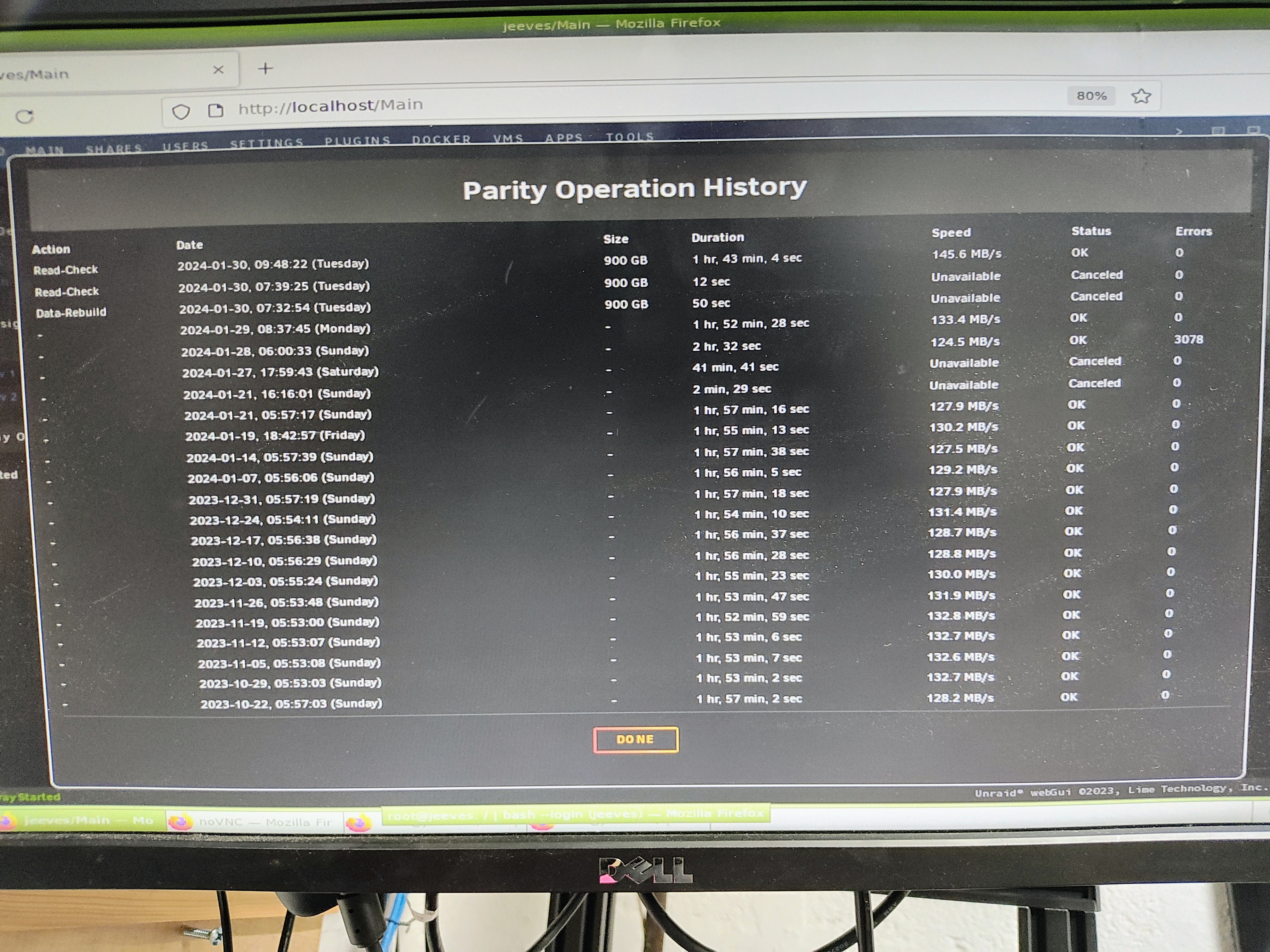

I'm one of those dummies who has my pfsense in a vm (i know i know) so i cant download diagnostics, but heres a pic of the History - looks like parity should still be valid from the old drive.

Since we don't have diagnostics from then can't say much about why the emulated disk was unmountable. Possibly connection problems with other disks in the array made emulation not work.

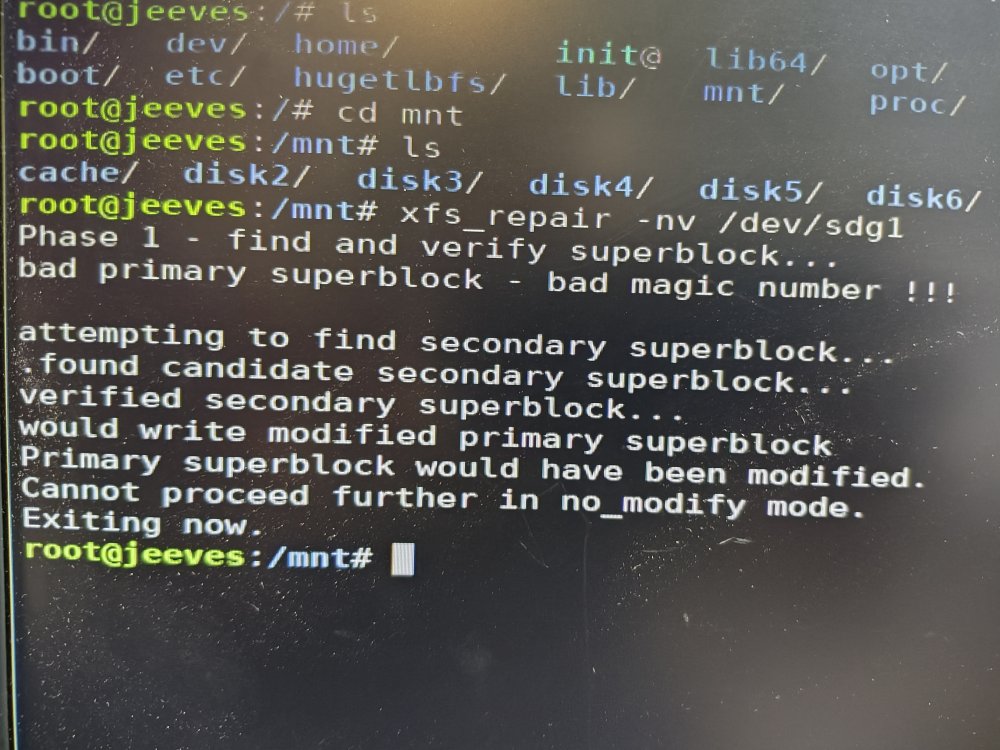

If it said unmountable, then it was rebuilding an unmountable filesystem. Formatting an unmountable filesystem will make it mountable, but it will also make it empty. Formatting the emulated disk will result in an empty rebuild.
The correct way forward when you have an unmountable disk is check filesystem. And that may be what we have to do with the original disk before UD can mount it. Or we might have to do that if you go the new pool way if it is unmountable.

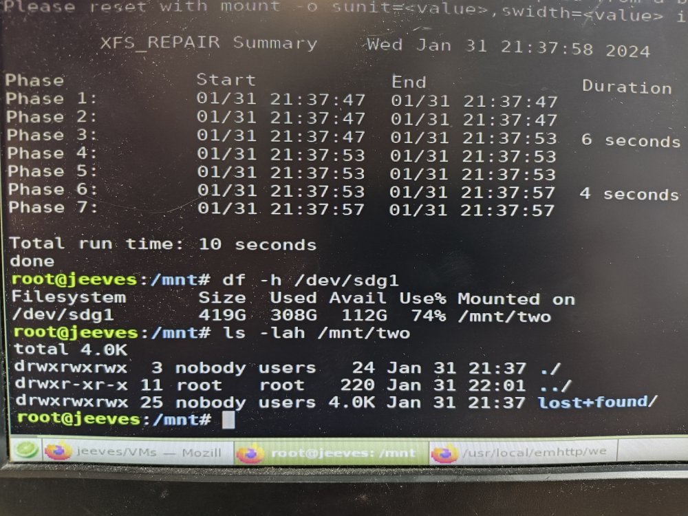

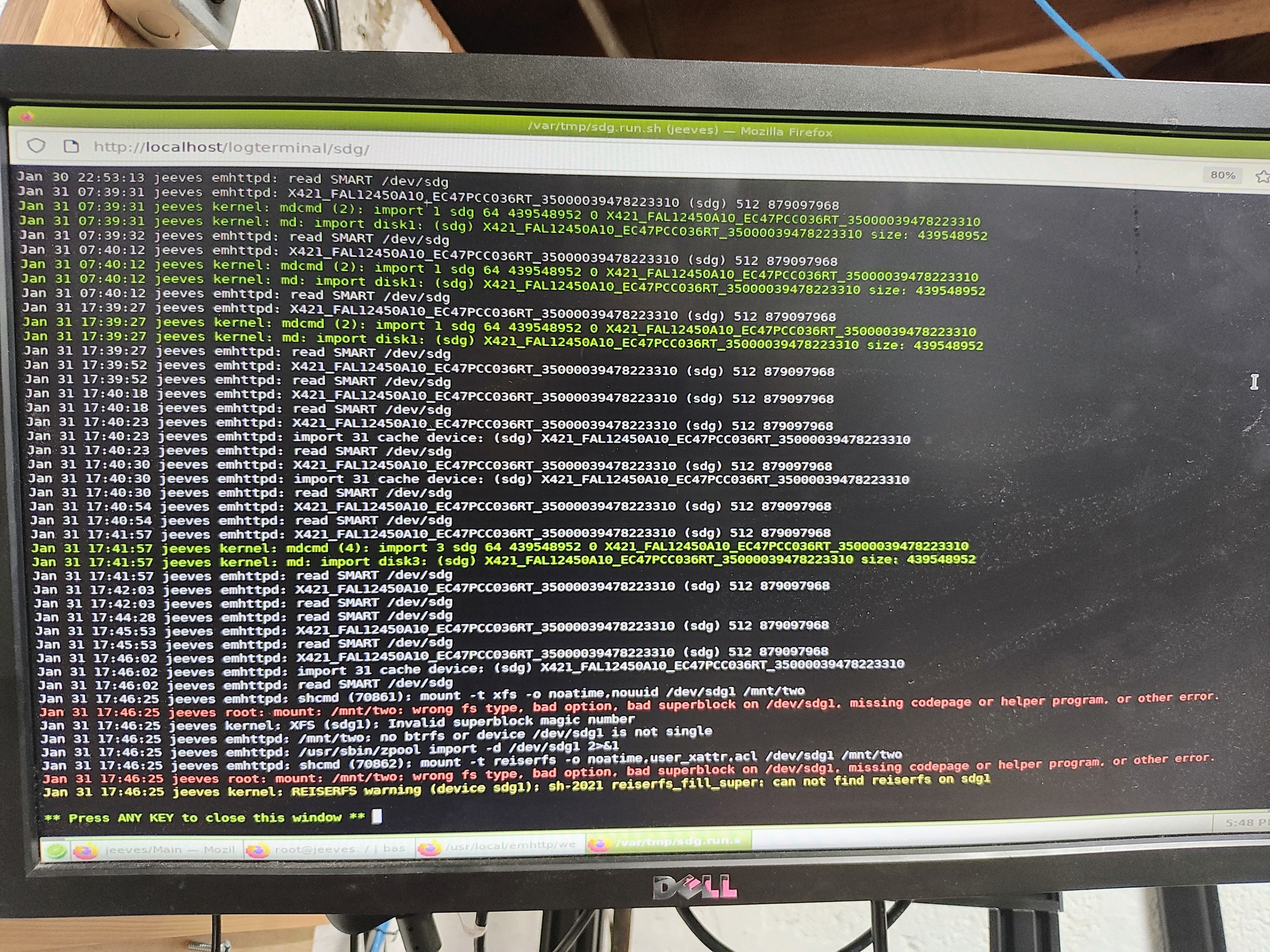

Ok i added the new 900gb drive to it's place in the array (disk3), added the old disk3 (450gb) to a new pool, and started the array.
old disk 3 (450gb) says unmountable, this is the disk log:

You have a pool named 'two'. Is that the old array disk we are trying to get the data from ?
