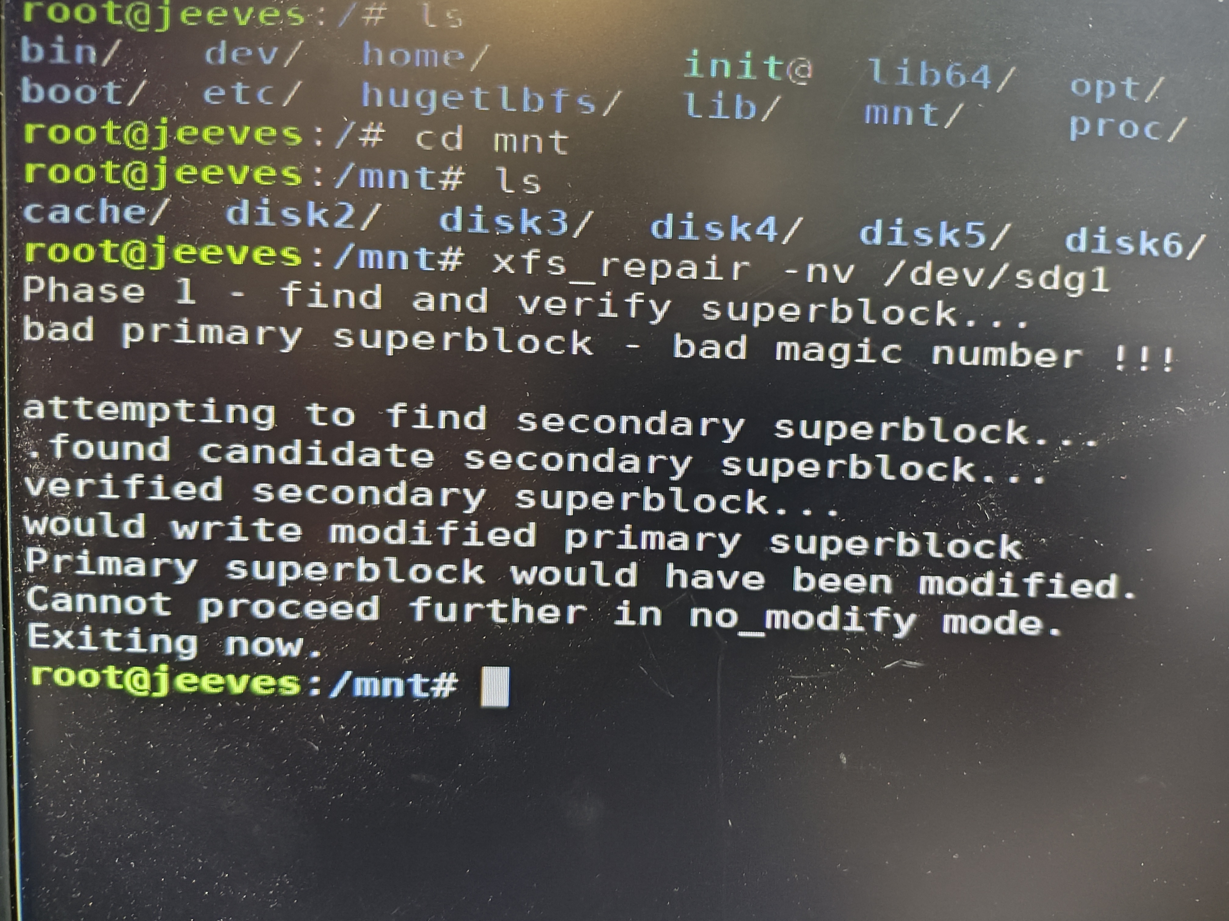

This is less than ideal, because normally I would ask for you to post the output of this command:
xfs_repair -nv /dev/sdg1
It may not all fit on one screen for you to photograph.
short output:

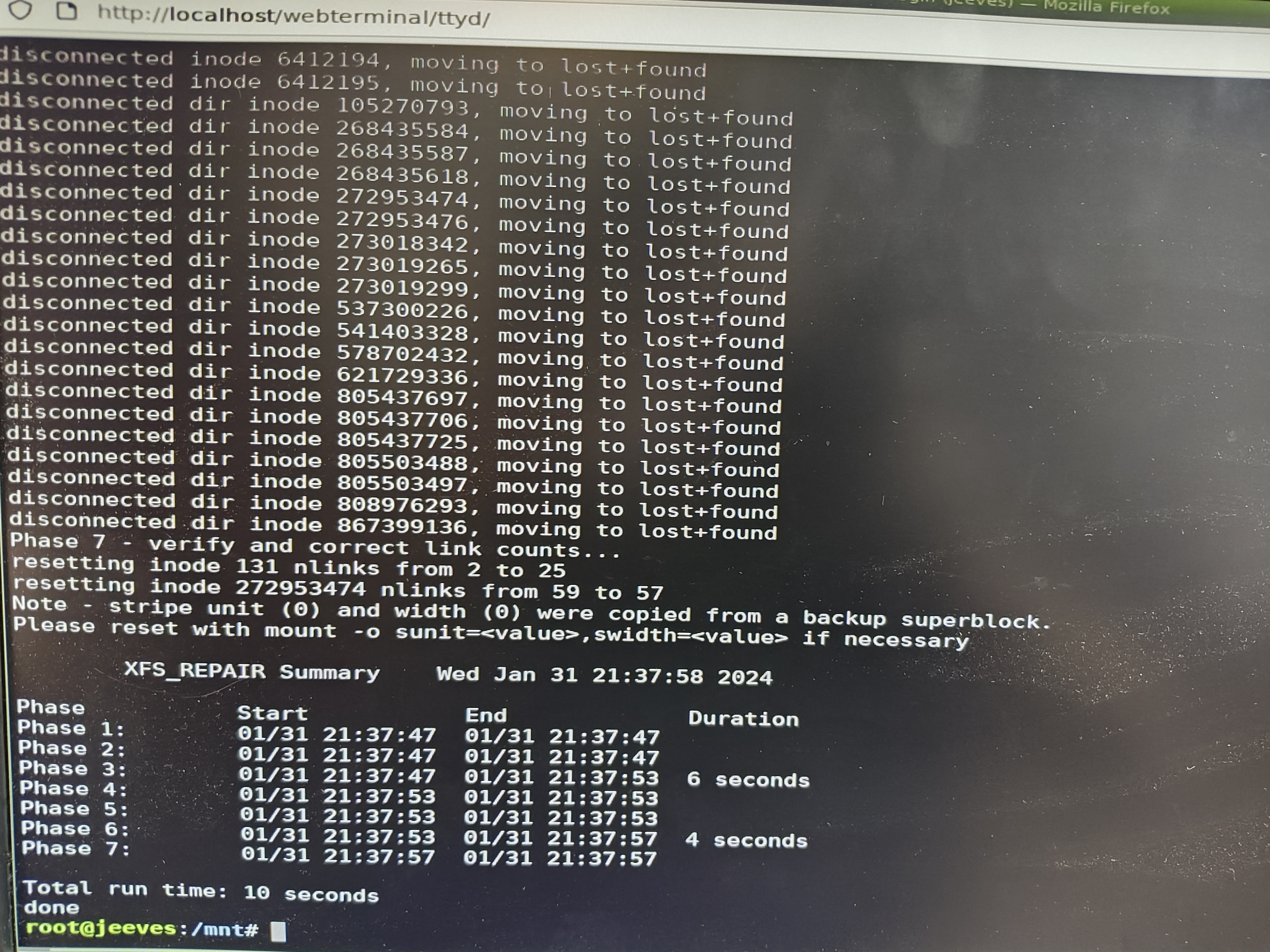

OK, now without -n
xfs_repair -v /dev/sdg1
only took a few sec, here's the final output:
Are you booted in GUI mode or are you working completely at the command line?
Oh I see the Firefox at the top of the photo so must be GUI.
Stop and restart the array, and see if pool 'two' shows it has contents.
it mounted! contents look like:
