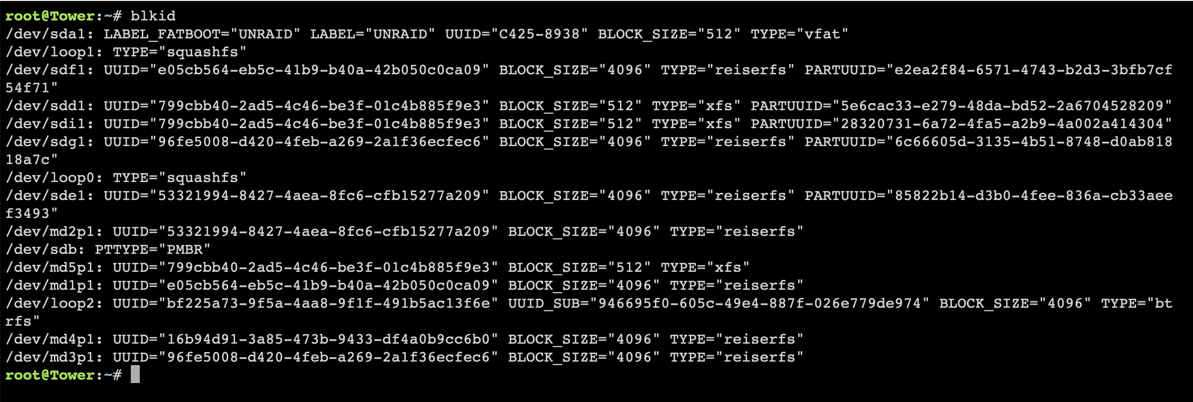

post the output of
blkid
Just noticed ReiserFS. Instead of rebuilding ReiserFS you should be working toward copying that data to other disks that are not ReiserFS.

OK, it looks like disks 4 and 5 were already XFS so OK to rebuild those (but not OK to format). Maybe copying the others was the reason for upsizing?
Disk4 was reiserfs, were you trying to rebuild as xfs? That won't work, click on disk4, change fs to reiser and post new diags after array start.
I see that now. I was looking at vars so they must have tried to change it.
And of course, they had already formatted disk5 as xfs. Probably it was reiserfs before.
