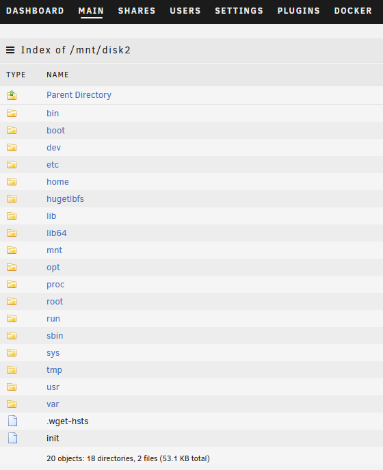

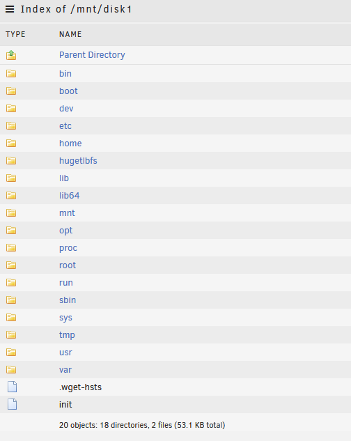

I posted a few days ago.  (link below) I ran in emulated mode for a few days.  The new drive arrived, I shut down the system and inserted the new drives and selected one of them as DISK1.  Started up the array and the re-build was in process like I expected.  I even started throwing some of my backup-ed files back on the array as the parity check was going.  I went to bed.  I check it this AM, all my shares are missing.... I browse DISK1 and DISK2 now, and it looks like the root of a *nix system!  (see screenshot)
I'm beside myself.  I replaced a dozen drives in the same way and I just don't understand.  I just don't know what to do anymore.  I've stop the array rebuild and won't touch the system until someone gives me some more guidance.
