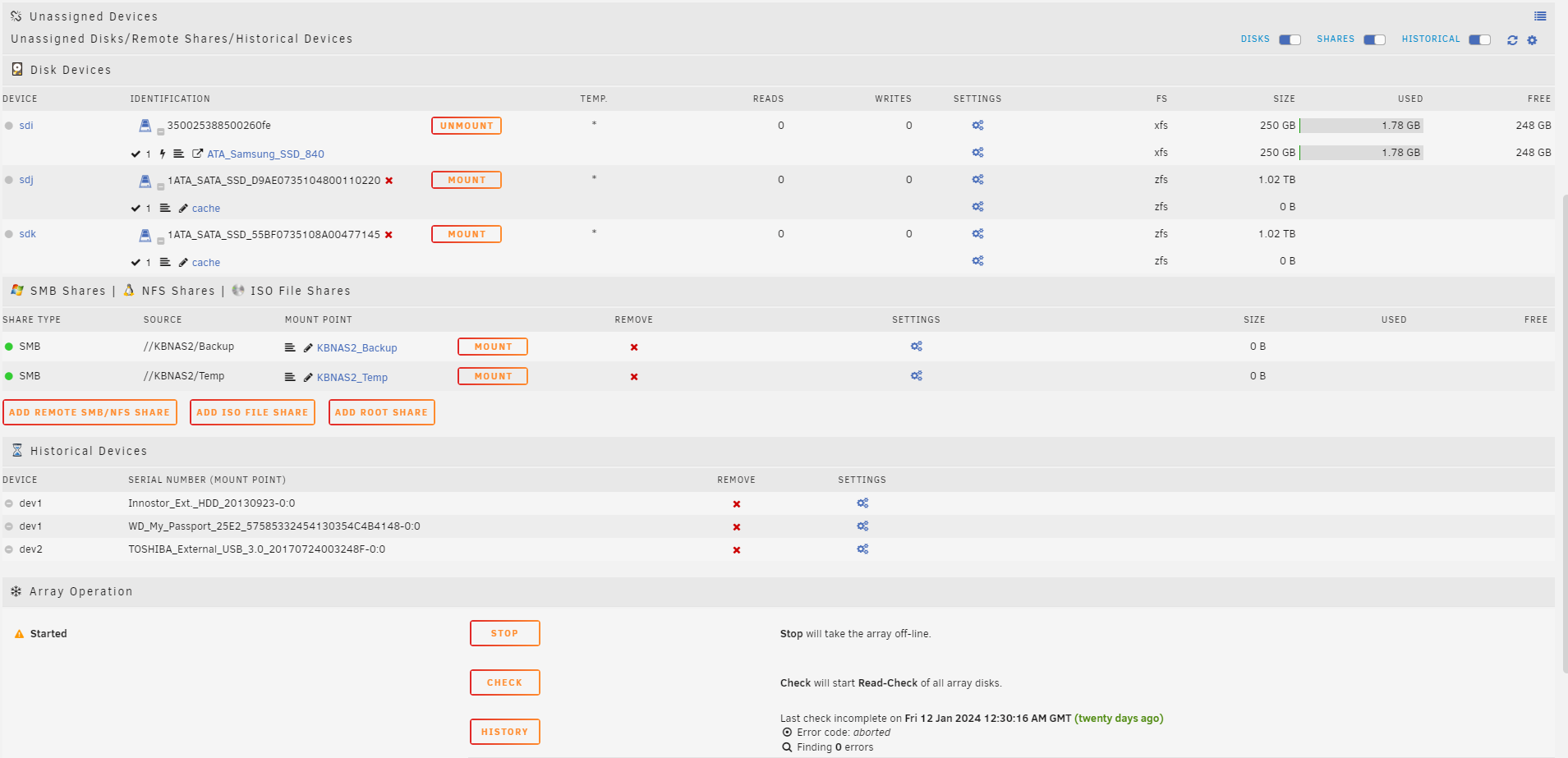

Help please - Cache Dead?
Randomly, last night, with no activity, a 250gb SSD appeared to die.
But, the other 2 1tb SSD's, running my cache pool, also seem to have been affected.
All 3 SSD's are running from a PCI raid card, into an icydock 4-disk caddy, which hasn't been a problem since I set up this server about 6 months ago.
I was going to stop the array and check the disks, but the Array will not stop.
It's also not possible to collect Diagnostics, it hangs at,
cp /etc/libvirt/qemu/*.xml '/kbnas-diagnostics-20240201-1657/xml' 2>/dev/null
Obviously, it wants to access my unmounted cache disk for this... see screenshots and attached syslog.
What's the best way to proceed, please?
Thanks
Kev

Should I just mount the 2 SSD's used for cache?
But why are they in UD?
Looks like the device dropped offline, reboot the server, type reboot on the CLI, if it doesn't reboot after 5 minutes you will need to force it, then post new diags after array start.

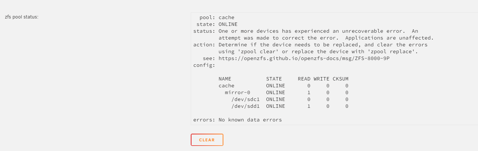

Would you suggest to hit 'Clear' - OR run 'zpool clear'.

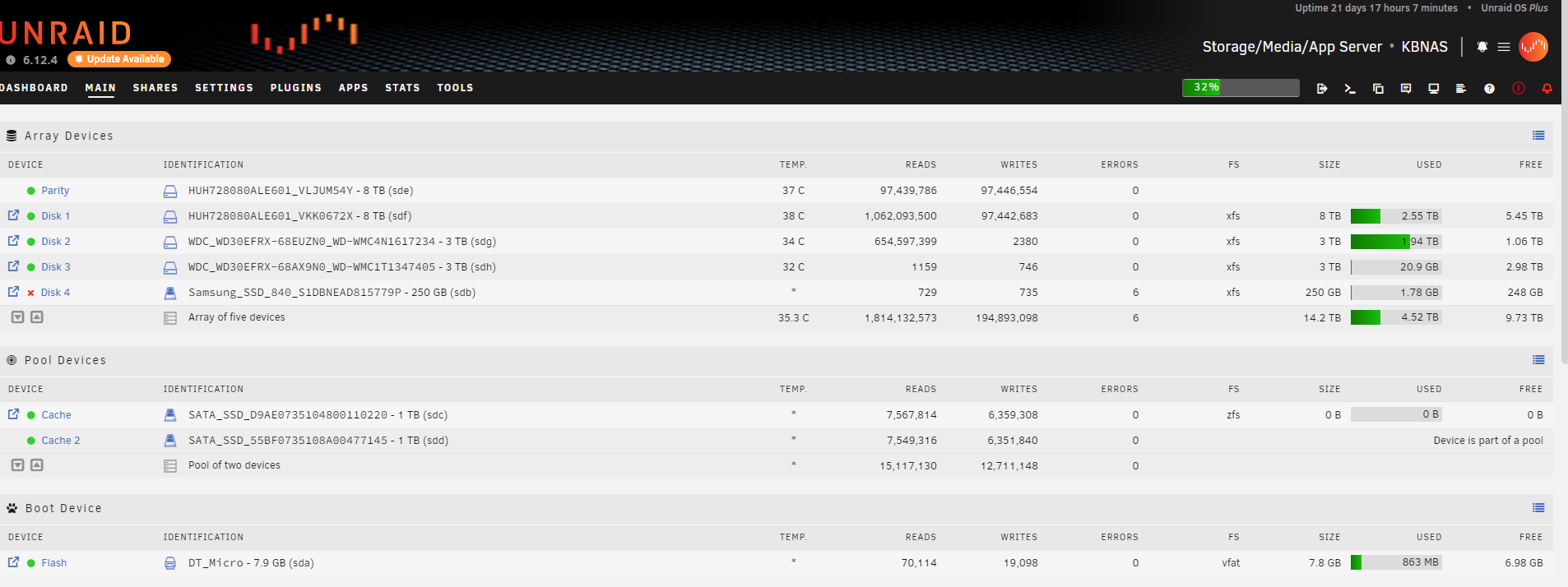

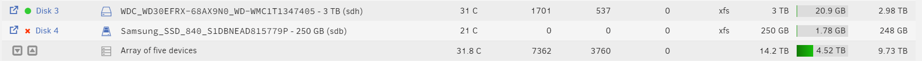

And what about Disk 4?
Also showing no errors - but...
It's the same, the error was during pool import.

I guess the same thing happened with Disk 4 - Should I readd it - or remove it?
Possibly, you can rebuild if you need it, if you don't really use, it might be better to just remove it.
@JorgeB Update - I wanted to run 'zpool clear' but it didn't show the 'Clear' Button, only 'Scrub' So I ran that and it it finished quite fast.
I rebooted and saw a lot more Disk errors in the logs. I ran the scrub again, then it took the pool into DEGRADED mode and showed a errors for one of the disks..
It hung at about 68%. (3+ hrs)
I forced a hard shutdown/restart and ran a Scrub again - This time it showed loads of errors for both disks and went to SUSPENDED > DISABLED > SUSPENDED > DEGRADED status, and it seemed to hang again, although the UNRAID GUI was still responsive; I could not stop/start the Array. With more Device & I/O errors filling up the logs..
