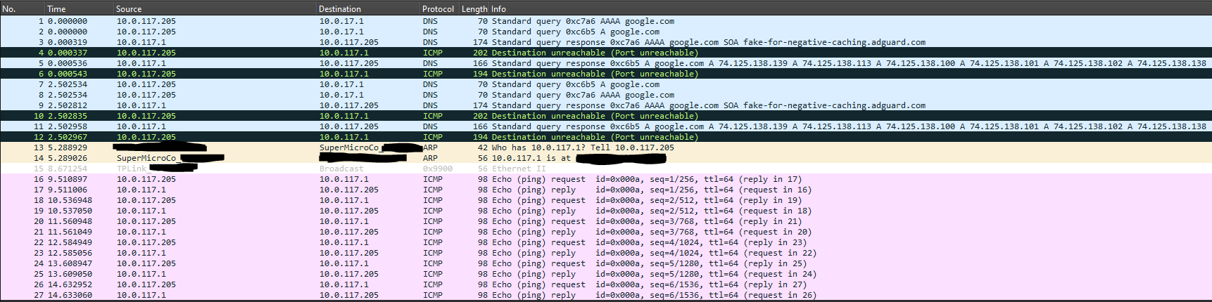

When I ping or nslookup google I just get host unreachable. I can see the traffic showing up in OPNsense, I can see the DNS queries in AdGuard log, so I know it's getting to the places it needs to go, but it's like it just doesn't send the packet back to the container.

Attached a tcpdump output where I tried to ping google.com and then subsequently successfully pinged 10.0.117.1. Pinging 8.8.8.8 directly also works perfectly fine.
Again, VM works fine, so I have most likely narrowed it down to docker and not any upstream routing rules, but open to all suggestions.

What I did to fix this was to force --dns=10.0.117.1 on the Docker container.
I believe the issue is that my DNS server on my OPNSense router was listening on all interfaces, including the VLAN interface, and it was replying from both the default interface address and the VLAN interface, so I was getting a duplicate response which was causing issues.
Originally I had only tried forcing --dns=10.0.17.1 (the DNS of my main LAN) and that wasn't working, I didn't think to try the gateway of the VLAN instead, but that was the solution for me.
