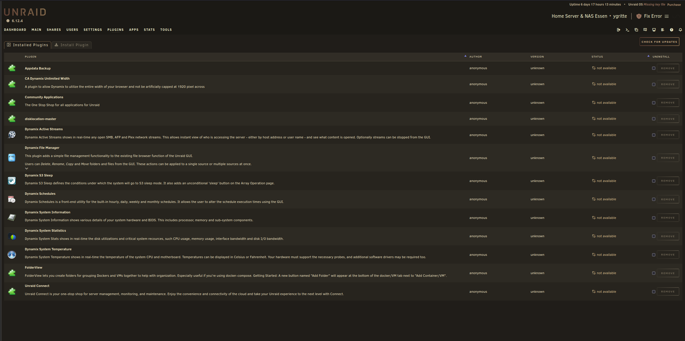

The main dashboard was no longer accessible, exported NFS shares that I usually mount on my laptops and workstation were no longer accessible.

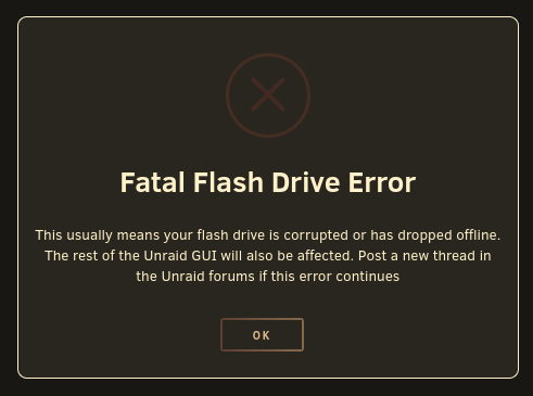

Checking up on the errors I got presented with notifications which all point to the attached Flash Drive being no longer available. Like for example when accessing the "Apps" item in the main menu bar results in a popup telling me "Fatal Flash Drive Error - This usually means your flash drive is corrupted or has dropped offline. The rest of the Unraid GUI will also be affected. Post a new thread in the Unraid forums if this error continues" -- Well, this error continues, so here I am.
