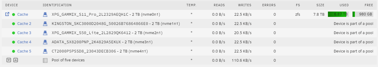

Background: I have 5x 2TB NVMe SSDs in a RaidZ1 pool (non encrypted, some datasets have compression and some do not), used as my cache.  I'm sitting between 80% and 90% utilization at any given time (8TB usable, ~1TB free).
Moving large files within the pool is very slow compared to when I was running the same drives in a BTRFS Raid1 pool (5TB usable).  Moving a 5GB file from folder A to folder B within the cache gives me consistently less than 500MB/s transfer speed (usually much less), while I was seeing around 1.5GB/s on BTRFS.
Not sure what I can check here.  Could this be due to the higher pool utilization?  I have a 10th gen i7 and 48GB of RAM, and the system isn't taxed.  The PCIe bus is 3.0 and all NVMe's have DRAM.

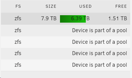

What is the current pool utilization?
I've moved from a btrfs raid5 pool to zfs raidz1 pool and see similar speeds, even a little faster with zfs, I used to get around 1GB/s, now get 1.5GB/s when copying data inside the pool.
Sitting at 88% right this minute:
