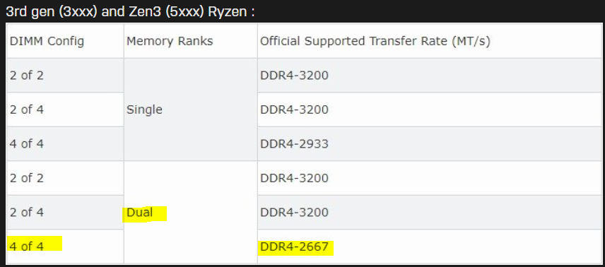

Ryzen with overclocked RAM like you have is known to corrupt data, so I would recommend correcting that and then recreate the pool.
Overclocked RAM? I wasn't aware I overclocked anything as I know servers don't care for it. Mind sharing where in the diags that is? Or how you came to see that I have overclocked RAM?
Meminfo.txt in the diags, for your config RAM should be set @ 2666MT/s max, it's running @ 3200MT/s.
I see the speed set to 3200MT in the meminfo.txt file, but I couldn't find where you saw that it should be 2666.
Click the link I've posted above.
