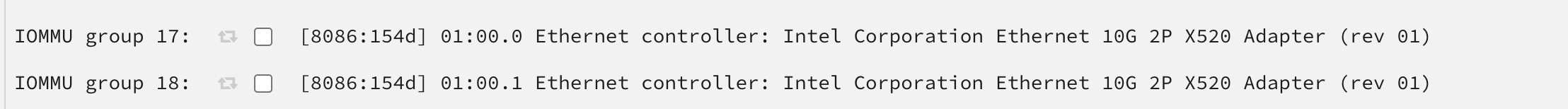

February 2, 20242 yr Hi All, at a bit of a loss and trying to fend off frustration but cant for the life of me figure out why my Intel X520 is not working in Unraid - Card shows up in System Devices but no Eth shows up in Network Config Settings - Even if my transceivers were incorrect the Eth jacks should still show up shouldnt threy? Ive tried looking into the Eprom of the card - before i adjusted the EPROM for additional transceivers I deleted the Network.cfg files and rebooted to the Gui and still wasnt able to see the eth adapters. Looks like the driver is in Use - and Im kind of at a loss here Do i need to inject a driver or add commands for boot? not sure where to go from here or how to determind the diagnostics file looking for help Feb 2 19:02:03 Whoville kernel: ixgbe: Intel(R) 10 Gigabit PCI Express Network Driver Feb 2 19:02:03 Whoville kernel: ixgbe: Copyright (c) 1999-2016 Intel Corporation. Feb 2 19:02:03 Whoville kernel: ixgbe: probe of 0000:01:00.0 failed with error -5 Feb 2 19:02:03 Whoville kernel: ixgbe: probe of 0000:01:00.1 failed with error -5 Thank you, Kelton whoville-diagnostics-20240202-1841.zip Edited February 3, 20242 yr by globadyne

February 3, 20242 yr Author I tried it in Ubuntu 22.04 and it worked albeit in a different board I wouldn't think I'm overloaded on my lanes 12 600k on a z790. I have an LSI HBA in the bottom slot driving for hard drives a singular NVME Oh, attempting to use this Intel X 520 card and I have two of the saddle plugs enabled on the board Even if the LSI card ran it has speed, it would still be more than enough. I wonder if it's something to do with the way the boards allocating I thought I saw a post on that

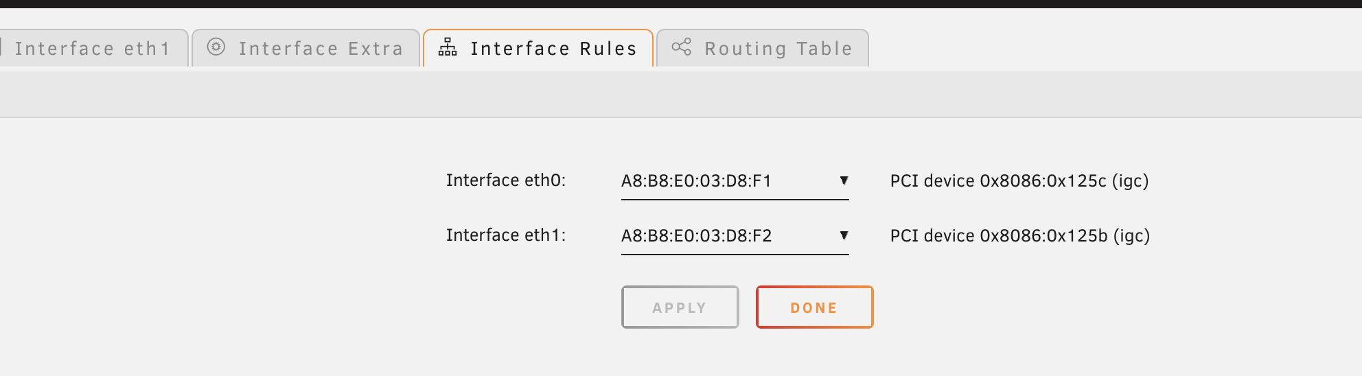

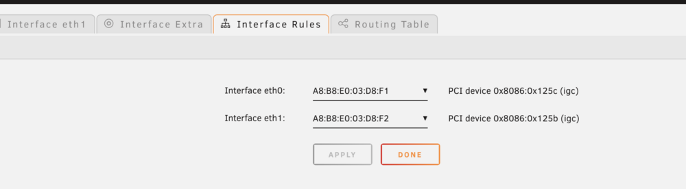

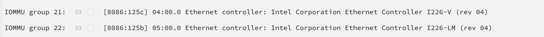

May 1, 20251 yr I'm having the same issue on Unraid 7, the server can see all 4 NICs on the System Devices page, but only the 2 internal NICs on the Network Setting page Any suggestions
May 1, 20251 yr Community Expert 7 minutes ago, LugoCloud said: I'm having the same issue on Unraid 7, the server can see all 4 NICs on the System Devices page, but only the 2 internal NICs on the Network Setting page Any suggestions Do the two 10Gs have drivers attached lspci -k
May 1, 20251 yr Just now, SimonF said: Do the two 10Gs have drivers attached lspci -k This is the output of the lspci -k Quote root@unraidserver:~# lspci -k 00:00.0 Host bridge: Intel Corporation Raptor Lake-S Host Bridge/DRAM Controller (rev 01) DeviceName: Onboard - Other Subsystem: Zycoo Co., Ltd Device 0760 00:01.0 PCI bridge: Intel Corporation Raptor Lake PCI Express 5.0 Graphics Port (PEG010) (rev 01) Subsystem: Zycoo Co., Ltd Device 0760 Kernel driver in use: pcieport 00:02.0 VGA compatible controller: Intel Corporation Raptor Lake-S GT1 [UHD Graphics 770] (rev 04) DeviceName: Onboard - Video Subsystem: Zycoo Co., Ltd Device 0760 Kernel driver in use: i915 Kernel modules: i915, xe 00:06.0 PCI bridge: Intel Corporation Raptor Lake PCIe 4.0 Graphics Port (rev 01) Kernel driver in use: pcieport 00:08.0 System peripheral: Intel Corporation GNA Scoring Accelerator module (rev 01) DeviceName: Onboard - Other Subsystem: Zycoo Co., Ltd Device 0760 00:0a.0 Signal processing controller: Intel Corporation Raptor Lake Crashlog and Telemetry (rev 01) DeviceName: Onboard - Other 00:14.0 USB controller: Intel Corporation Alder Lake-S PCH USB 3.2 Gen 2x2 XHCI Controller (rev 11) DeviceName: Onboard - Other Subsystem: Zycoo Co., Ltd Device 0760 Kernel driver in use: xhci_hcd 00:14.2 RAM memory: Intel Corporation Alder Lake-S PCH Shared SRAM (rev 11) DeviceName: Onboard - Other 00:15.0 Serial bus controller: Intel Corporation Alder Lake-S PCH Serial IO I2C Controller #0 (rev 11) DeviceName: Onboard - Other Subsystem: Zycoo Co., Ltd Device 0760 00:15.1 Serial bus controller: Intel Corporation Alder Lake-S PCH Serial IO I2C Controller #1 (rev 11) DeviceName: Onboard - Other Subsystem: Zycoo Co., Ltd Device 0760 00:15.2 Serial bus controller: Intel Corporation Alder Lake-S PCH Serial IO I2C Controller #2 (rev 11) DeviceName: Onboard - Other Subsystem: Zycoo Co., Ltd Device 0760 00:15.3 Serial bus controller: Intel Corporation Alder Lake-S PCH Serial IO I2C Controller #3 (rev 11) DeviceName: Onboard - Other Subsystem: Zycoo Co., Ltd Device 0760 00:16.0 Communication controller: Intel Corporation Alder Lake-S PCH HECI Controller #1 (rev 11) DeviceName: Onboard - Other Subsystem: Zycoo Co., Ltd Device 0760 Kernel driver in use: mei_me Kernel modules: mei_me 00:16.3 Serial controller: Intel Corporation Alder Lake-S Keyboard and Text (KT) Redirection (rev 11) DeviceName: Onboard - Other Subsystem: Zycoo Co., Ltd Device 0760 Kernel driver in use: serial 00:17.0 SATA controller: Intel Corporation Alder Lake-S PCH SATA Controller [AHCI Mode] (rev 11) DeviceName: Onboard - SATA Subsystem: Zycoo Co., Ltd Device 0760 Kernel driver in use: ahci Kernel modules: ahci 00:19.0 Serial bus controller: Intel Corporation Alder Lake-S PCH Serial IO I2C Controller #4 (rev 11) DeviceName: Onboard - Other Subsystem: Zycoo Co., Ltd Device 0760 00:19.1 Serial bus controller: Intel Corporation Alder Lake-S PCH Serial IO I2C Controller #5 (rev 11) DeviceName: Onboard - Other Subsystem: Zycoo Co., Ltd Device 0760 00:1a.0 PCI bridge: Intel Corporation Alder Lake-S PCH PCI Express Root Port #25 (rev 11) Subsystem: Zycoo Co., Ltd Device 0760 Kernel driver in use: pcieport 00:1c.0 PCI bridge: Intel Corporation Alder Lake-S PCH PCI Express Root Port #1 (rev 11) Subsystem: Zycoo Co., Ltd Device 0760 Kernel driver in use: pcieport 00:1c.1 PCI bridge: Intel Corporation Alder Lake-S PCH PCI Express Root Port #2 (rev 11) Subsystem: Zycoo Co., Ltd Device 0760 Kernel driver in use: pcieport 00:1c.4 PCI bridge: Intel Corporation Alder Lake-S PCH PCI Express Root Port #5 (rev 11) Subsystem: Zycoo Co., Ltd Device 0760 Kernel driver in use: pcieport 00:1e.0 Communication controller: Intel Corporation Alder Lake-S PCH Serial IO UART #0 (rev 11) DeviceName: Onboard - Other Subsystem: Zycoo Co., Ltd Device 0760 00:1e.3 Serial bus controller: Intel Corporation Alder Lake-S PCH Serial IO SPI Controller #1 (rev 11) DeviceName: Onboard - Other 00:1f.0 ISA bridge: Intel Corporation Device 7a83 (rev 11) DeviceName: Onboard - Other Subsystem: Zycoo Co., Ltd Device 0760 00:1f.3 Audio device: Intel Corporation Alder Lake-S HD Audio Controller (rev 11) DeviceName: Onboard - Sound Subsystem: Realtek Semiconductor Co., Ltd. Device 0897 00:1f.4 SMBus: Intel Corporation Alder Lake-S PCH SMBus Controller (rev 11) DeviceName: Onboard - Other Subsystem: Zycoo Co., Ltd Device 0760 Kernel driver in use: i801_smbus Kernel modules: i2c_i801 00:1f.5 Serial bus controller: Intel Corporation Alder Lake-S PCH SPI Controller (rev 11) DeviceName: Onboard - Other Subsystem: Zycoo Co., Ltd Device 0760 01:00.0 Ethernet controller: Intel Corporation Ethernet 10G 2P X520 Adapter (rev 01) Subsystem: Intel Corporation 10GbE 2P X520 Adapter Kernel driver in use: ixgbe Kernel modules: ixgbe 01:00.1 Ethernet controller: Intel Corporation Ethernet 10G 2P X520 Adapter (rev 01) Subsystem: Intel Corporation 10GbE 2P X520 Adapter Kernel driver in use: ixgbe Kernel modules: ixgbe 02:00.0 Non-Volatile memory controller: Sandisk Corp WD Blue SN580 NVMe SSD (DRAM-less) (rev 01) Subsystem: Sandisk Corp WD Blue SN580 NVMe SSD (DRAM-less) Kernel driver in use: nvme Kernel modules: nvme 03:00.0 System peripheral: Global Unichip Corp. Coral Edge TPU Subsystem: Global Unichip Corp. Coral Edge TPU Kernel driver in use: apex Kernel modules: apex 04:00.0 Ethernet controller: Intel Corporation Ethernet Controller I226-V (rev 04) Subsystem: Intel Corporation Device 0000 Kernel driver in use: igc Kernel modules: igc 05:00.0 Ethernet controller: Intel Corporation Ethernet Controller I226-LM (rev 04) Subsystem: Intel Corporation Device 0000 Kernel driver in use: igc Kernel modules: igc 06:00.0 System peripheral: Global Unichip Corp. Coral Edge TPU Subsystem: Global Unichip Corp. Coral Edge TPU Kernel driver in use: apex Kernel modules: apex
