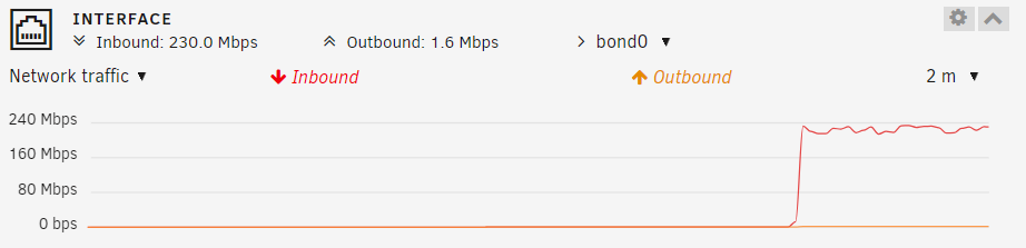

I was trying to send a large file (>1GB) to a share on my newly set up unraid -> Speed only goes up to ~ 26MB/s
Tried again with a SSD Pool share instead of array as target : Same result.
Connected my laptop with disabled wifi via cable to the same switch as unraid is connected to: Only slightly better rate but still <30MB/s
I changed the LAN cable for the unraid pc and the one between the switch to which unraid is hooked up and the main router/switch in my network.
Unraid Home screen shows:
eth3:  1000 Mbps, full duplex, mtu 1500   --> should be capable of >100MB/s
Inbound:  226 Mbps
I tried to simplify as much as possible by writing straight to an NVME share und eliminating faulty LAN connections.

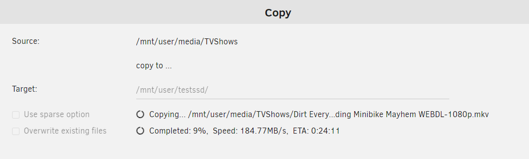

Write speed internally array to cache nvme is fine (190 MB/s)

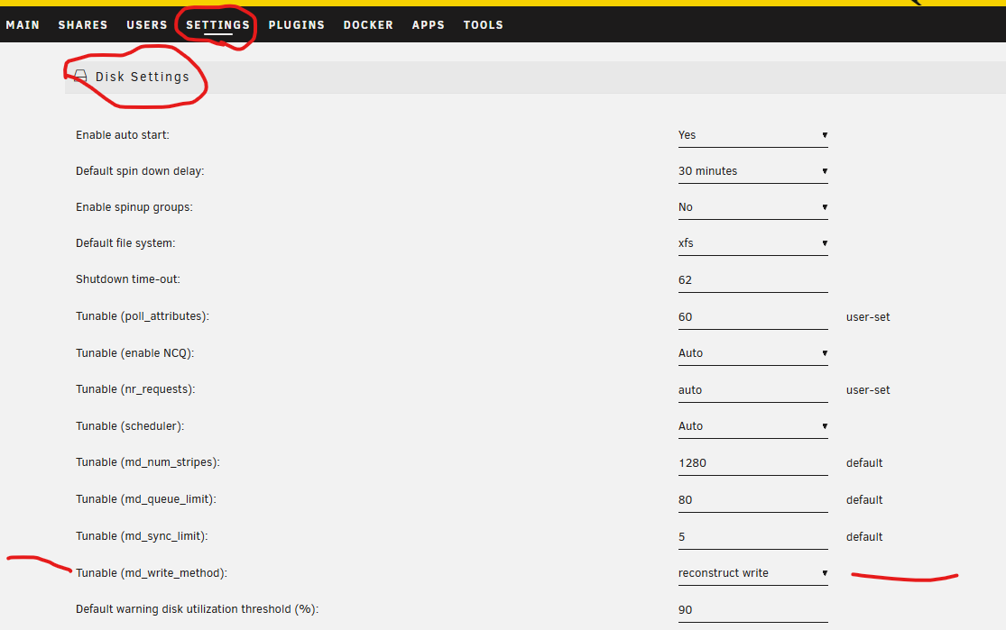

Also try using the 'Write-reconstruct' option as shown below:

This is writing from pc to unraid: (looks the same from another pc)

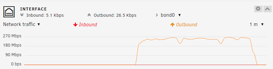

copy from unraid to pc:(looks the same on other pc as well)
copy array share to nvme share internally
None of the shares involved use secondary storage.. To me it is obious that the target drive is generally fast enough and CAN write much quicker. Data intake or export over LAN seems to be the problem. I have not tested the reconstruct write setting since the target is a nvme drive, the setting seems to be for turnable drives and drive performance doesnt seemt to be the issue.
The setting applied to drives in the main array regardless of what type of dtive they are.
