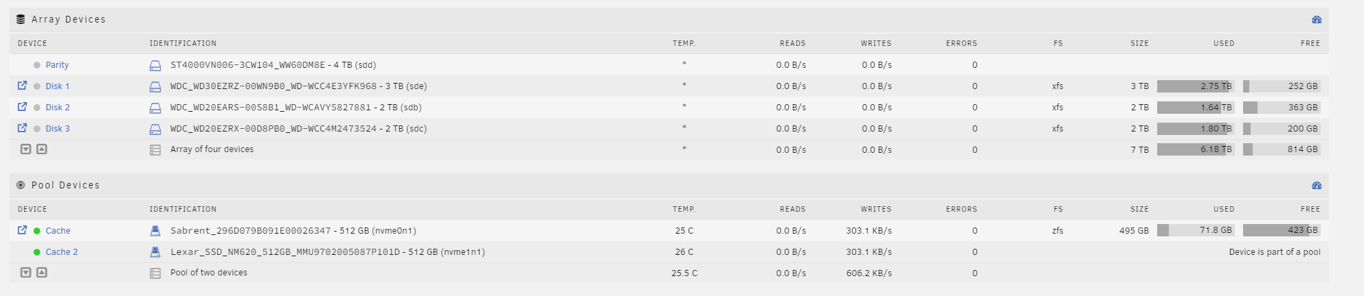

Strange, diags aren't showing the device stats, post a screenshot of main with reads/writes display showing speed.
here is the screenshot
in the meantime I am keeping the home assistant vm disabled and pihole docker stopped. I think the problem may be pihole because I see writes for about 1gb/h which seems exaggerated to me... Specifically how do I figure out which docker writes the most? I've tried the "File Activity" plugins but it only marks me vm writes.

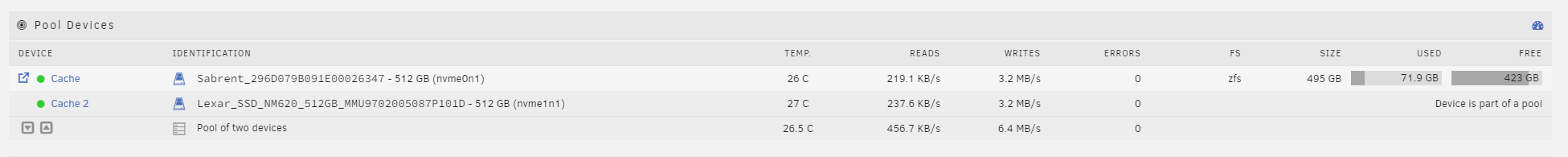

A few KB/s can be normal, MB/s or more is not.
Every now and then it has such peaks
With Home assistant's active VM I have just over 1gb/h and with dockers just as much, so about 2gb/h. In my opinion that's exaggerated!

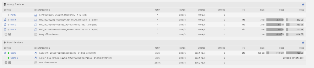

How can I understand who is doing the most writing and how often?
That doesn't seem wrong really. Just checked my desktop and laptop's drives and they got 4.3 / 7.5GB/h of writes over their lifetime so far respectively.
 2GB/h of writes on a typical 300TBW spec is 16.8 years.

With VMs enabled peeking to a few MB/s is normal, not with services disabled.
