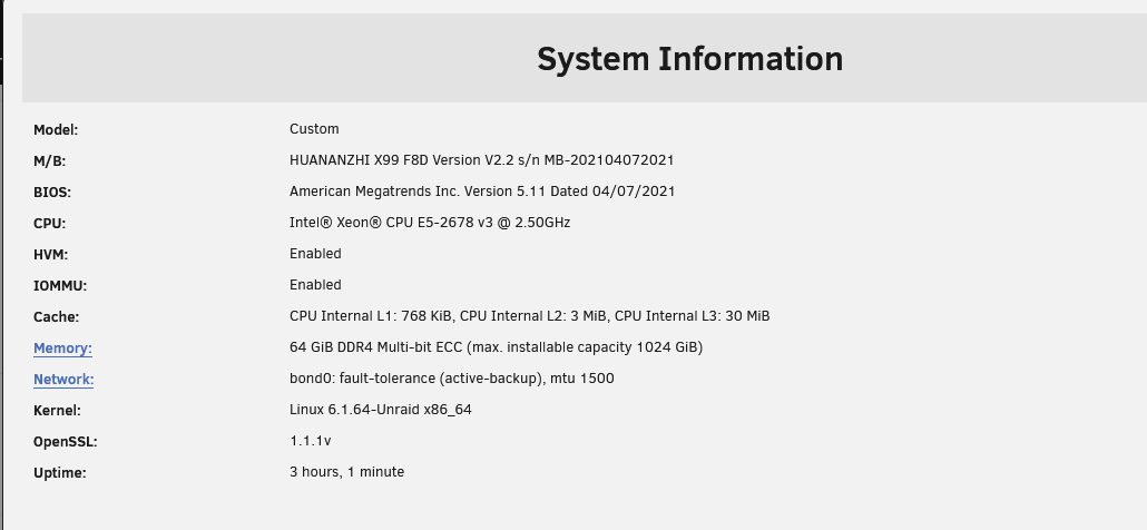

My Hardware specs :

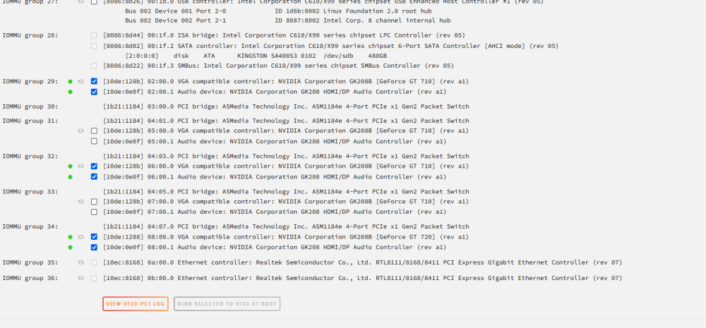

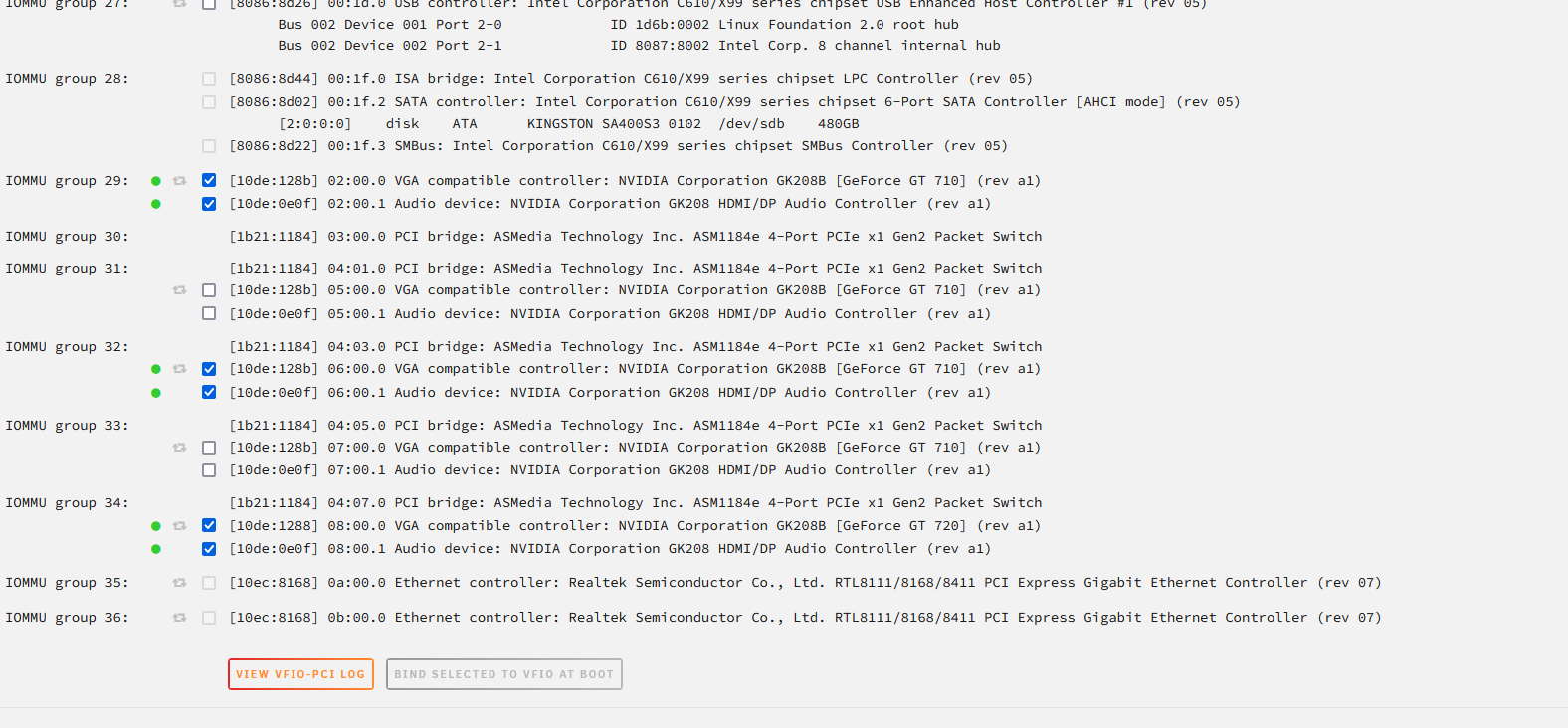

System devices:

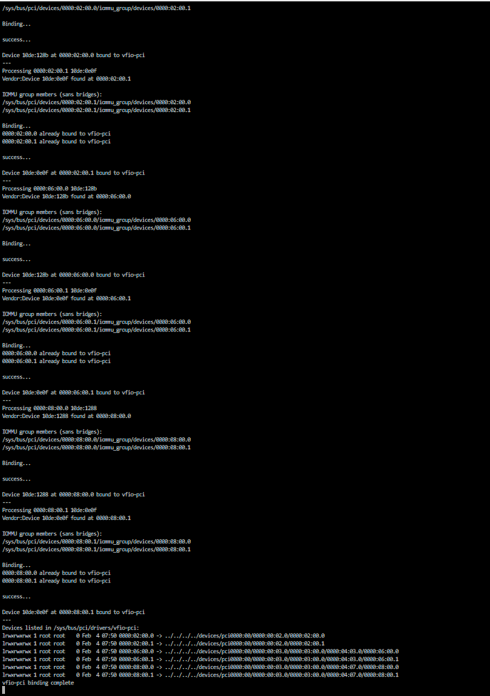

VFIO-PCI Log:

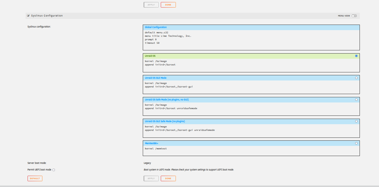

Syslinux config:

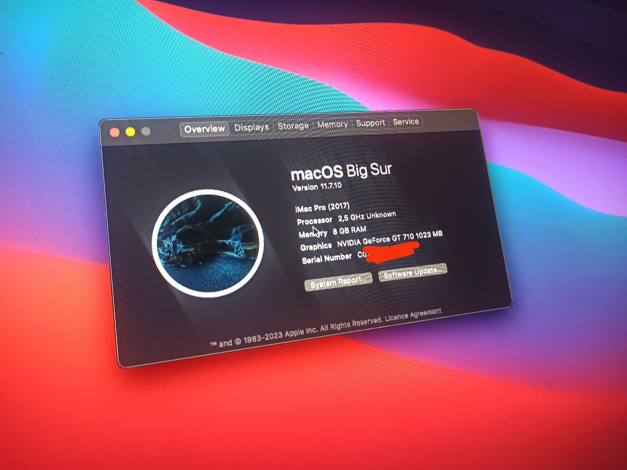

Solved by lomakor4
Update when i make first card virtual and second gt710 vm  starting but stuck on unraid logo
solved i forgot to save and change stock xml file
