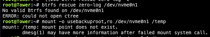

Hello, my cache drive seems to be corrupted out of nowhere. File system was btrfs. I tried running some commands that I found in another thread but I only got this as a response.

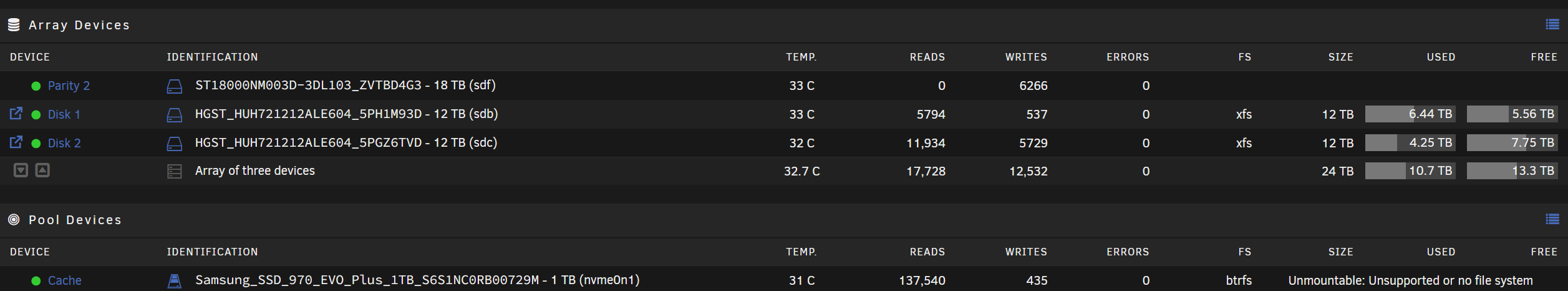

Image of the drive:

I have attached my diagnostics. Is the issue fixable without any data loss?

It does have an issue with the log tree, but the command you used in not correct, try:
btrfs rescue zero-log /dev/nvme0n1p1
Then re-start the array

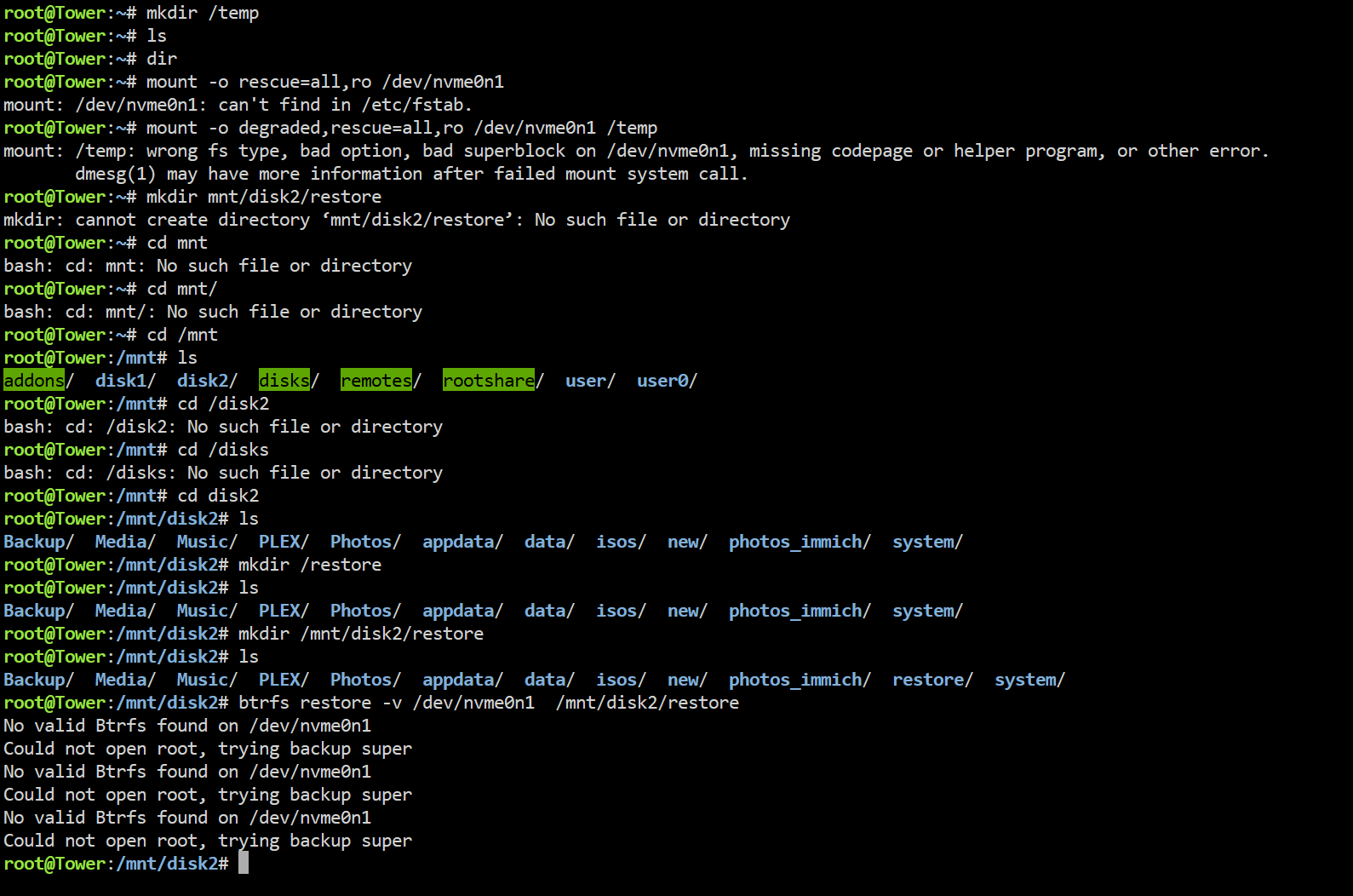

I've gone through some steps but didn't succeed, here is my Terminal LOG.
Update:
I've specified the wrong disk. I got a list of all btrfs drives by command:
btrfs fi show
and the correct command was
btrfs restore -vi /dev/nvme0n1p1 /mnt/disk2/restore
It was p1 that i was missing.
Restore in process, i get some errors like is it normal? it is because of failed disk sectors?
Can i try to repair it BTRFS check --repair (dangerous to use)? Or it will be in failed SMART mode forever?
What are my option to get the Unraid working as before? i ordered a new nvme drive.
Add it to the pool cache, copy files i recovered and its good to go? or its more complex issue

Did you try the mount read only option? That would be the best one option if it works.
sorry, no, i got errors on first steps due to p1, and completed only the last.
Yes it mounted, and i copied all the data. Thank you!
