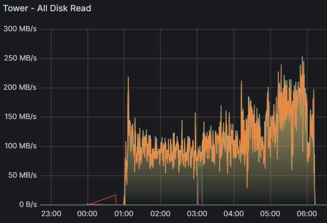

Scrub speeds range from 90MB/s to 250MB/s. shouldn't scrub speeds be a good bit faster? These Team group mp43's do 3000 read, 2400ish writes sequential. TLC NAND with DRAM.  5 hour 11 minutes for 6.3TB data used of 11.8TB
  pool: speedteam
 state: ONLINE
  scan: scrub repaired 0B in 05:11:58 with 0 errors on Thu Feb  1 06:11:59 2024

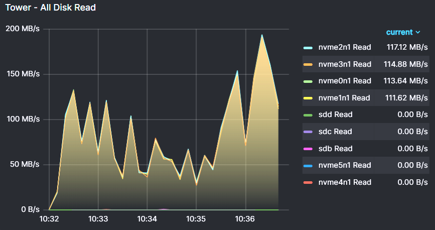

I captured the first 5 minutes of scrub AFTER it does the initial "indexing" or whatever operation:
  pool: speedteam
 state: ONLINE
  scan: scrub in progress since Mon Feb  5 10:30:29 2024
	7.92T scanned at 0B/s, 188G issued at 421M/s, 7.92T total
	0B repaired, 2.32% done, 05:20:51 to go
Disk IO: Writes are all less than 150kb/s. Reads in screenshot.

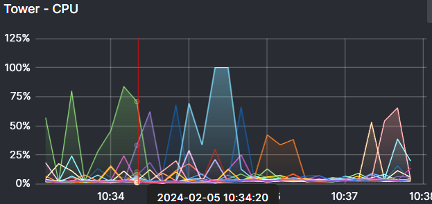

CPU is barely being taxed. mostly sitting around 3-10% across all threads, with occasional spikes to 50-100% Total CPU average under 6%.

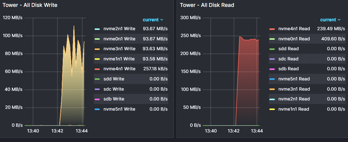

running a dd if=/dev/zero of=/mnt/user/speedtest oflag=direct bs=128k count=32k
reported 685MB/s in terminal, but grafana showed 2.03GB/s write to one nvme.

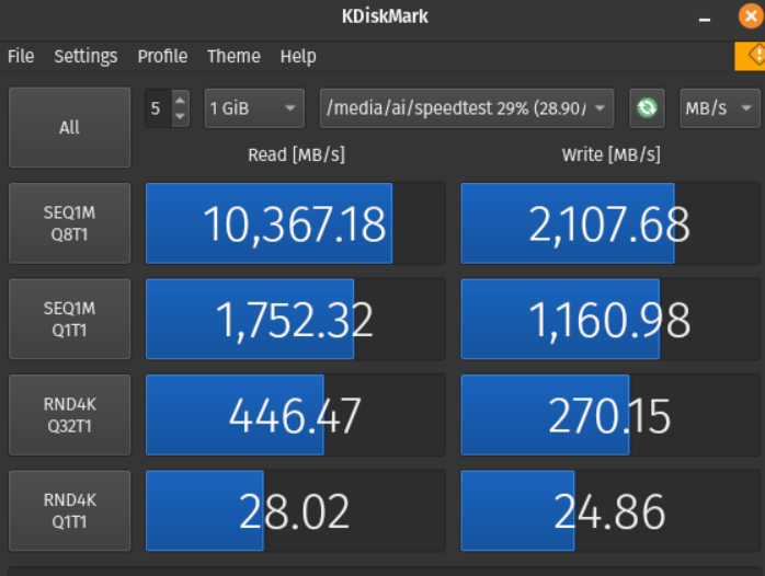

a VM with a vdisk mounted of the same zpool share running kdiskmark showed similar speeds to the screenshot in orig post.
dd is not a very good test, try copying one or more large files inside the pool, you can use Windows explorer for example, the data will be copied locally, it won't transverse the LAN, typically speeds should be around 1 to 2GB/s.
I copied a 27GB file to and from the same zpool mount. my desktop with smb mount to it is limited to 5GBps which this result is earily like reading and writing over the network making out the 5GBps.
These speeds should be bottlenecked by write speed of around 2GB/s...
