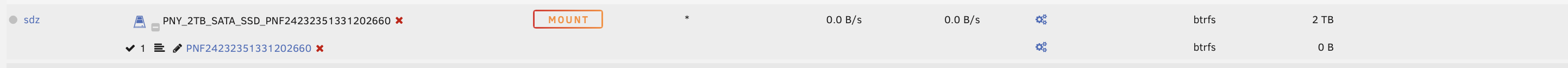

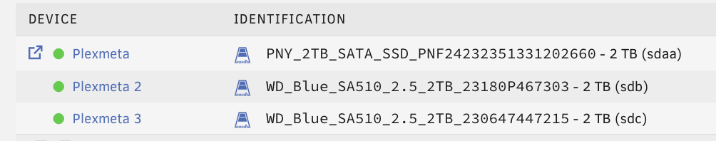

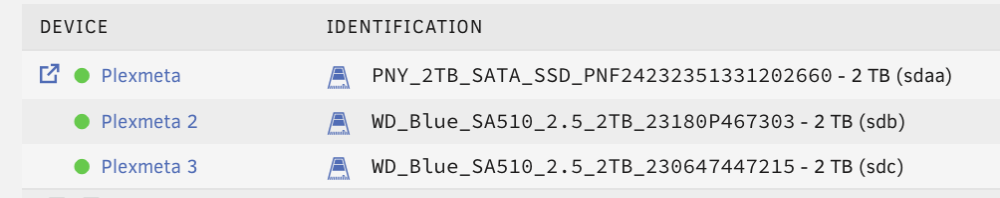

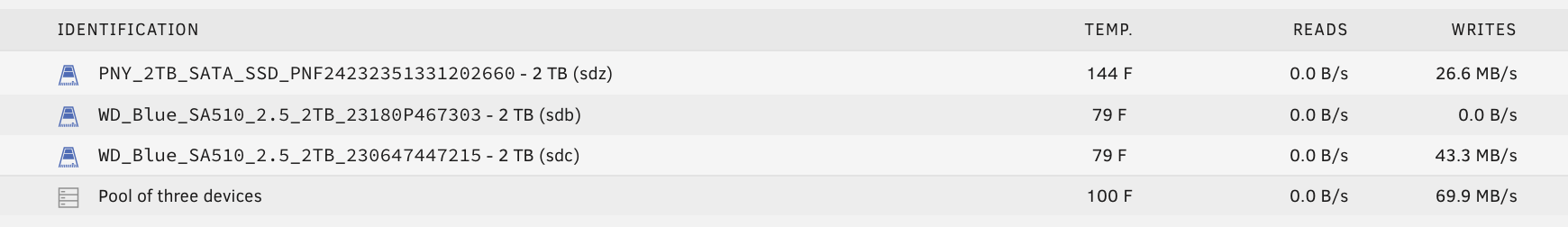

I also noticed that the 2TB PNY is now showing in the pool and under unassigned devices?

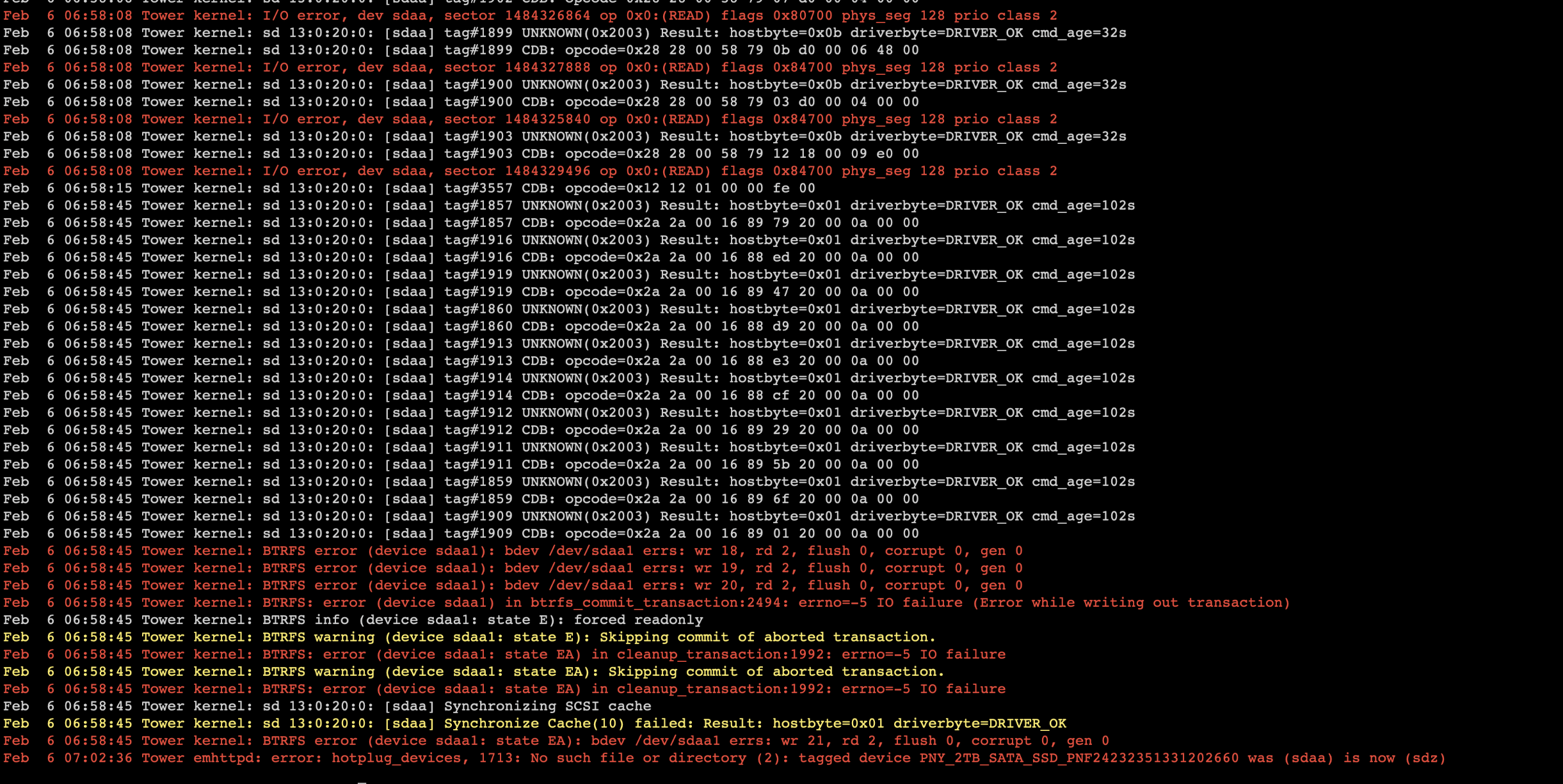

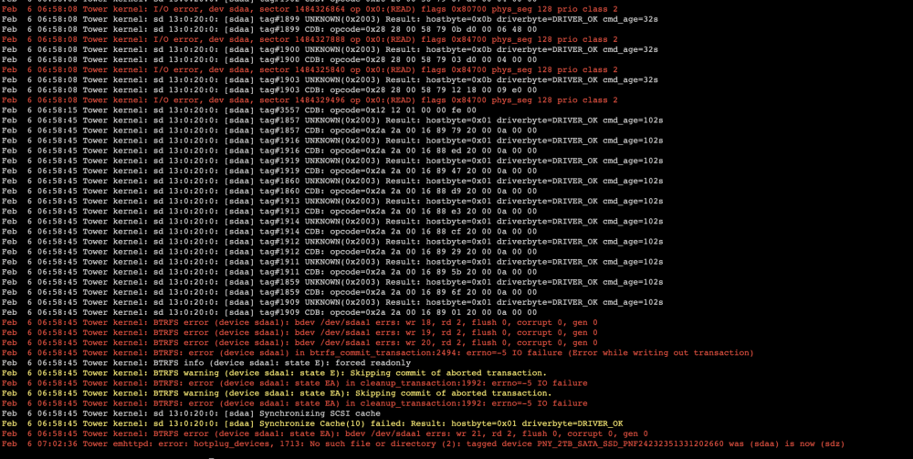

Disk Log for the 2TB PNY
777331224_Screenshot2024-02-06at7_18_10AM.thumb.png.b899286a00d690faf71f17b1f299c871.png
If the device still has issues with new cables it may be a device problem.
Rebooted and it cleared up the duplicated devices, the BTRFS Pool is doing something. pretty sure that PNY SSD is in the processes of dying... thought it was strange they both decided to bite the bullet at the same time.
