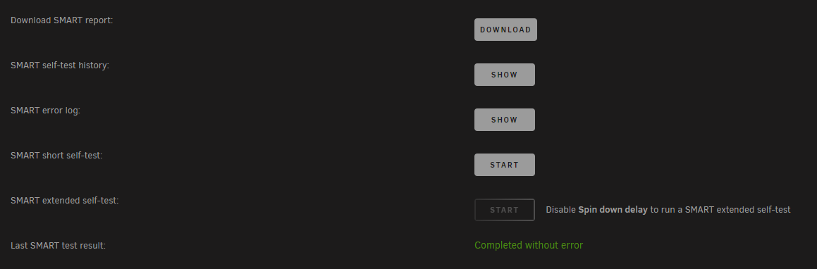

The disk is almost new (it has a couple of months), but today I saw that it has error on it and that the parity is not guaranteed anymore.
Before I pull out the disk and send it back in guarantee - could someone help me to understand if it's really a physical defect?
The SMART tells me all is ok...

Looking at the syslog this looks more like a connection issue (power or SATA) rather than a disk failure.
Connection issues are far more frequent than real disk failures.  Doing an extended SMART test is a good indication of it being OK if it passes
