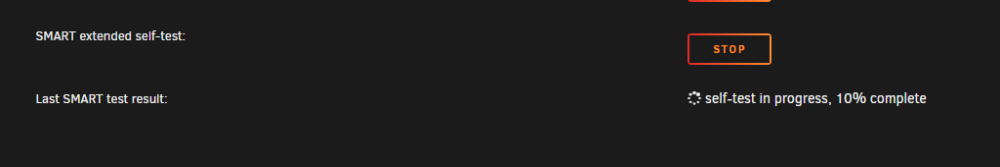

The disks have always been sufficiently cooled and I don't do THAT much reading and writing on them. I have also attached the Diagnostics. I've checked on BIOS whether the two disks can be detected properly and they are seen in BIOS.
I'm currently doing extended SMART self-test on both of them.

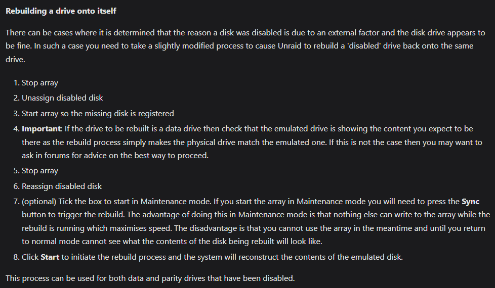

Disks were already disabled at boot, so we can't see what happened, but SMART looks fine for both, if they pass the test, the emulated disks are mounting and contents look correct, you can rebuild on top.
I'll rebuild on top once the scans are done. However, I'm not quite sure how to rebuild on top.
is this what you mean?
yes

Ok, I'll let the SMART test run and finish. If anything weird I'll update here again! Thanks !
