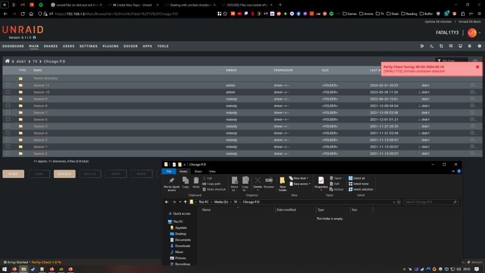

We just had a power outage so the server shutdown immediately. After bringing it back online I'm starting the array with a parity check. Strangely, many of the TV shows stored on Disk 1 are not showing under file explorer in Windows (and plex won't play them or other files that are visible). The shows and files do appear under the disk explorer in Unraid though. Shown this in the attached screenshot.
Are there certain steps I should take to fix this?

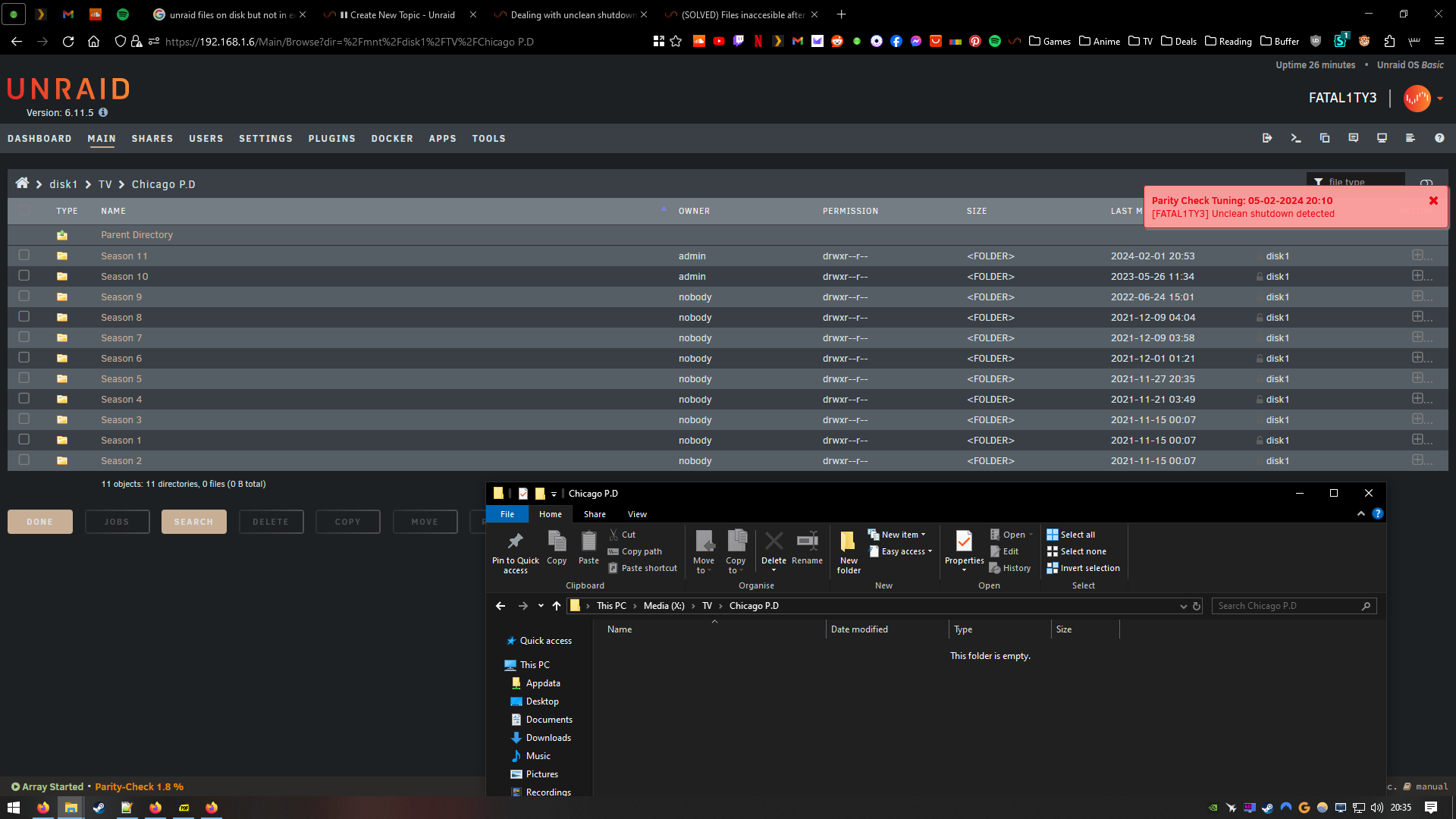

Like I said, the folders and files are visible when viewing in Unraid. In fact, I've just downloaded a file via the webui and it works perfectly fine. It's just that they've disappeared in file explorer.
Do you reckon it's a permission issue?

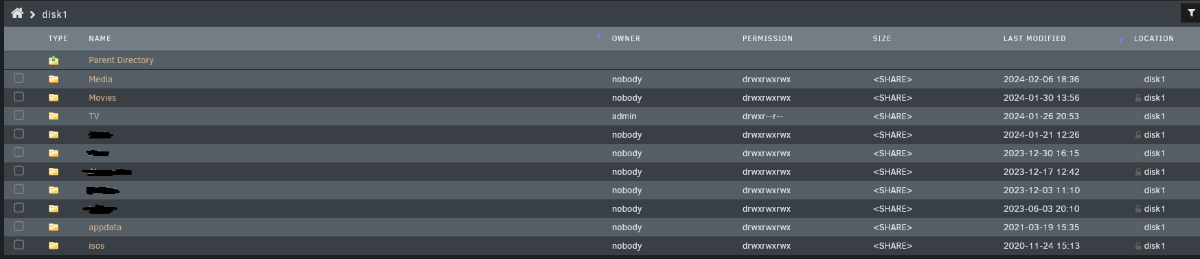

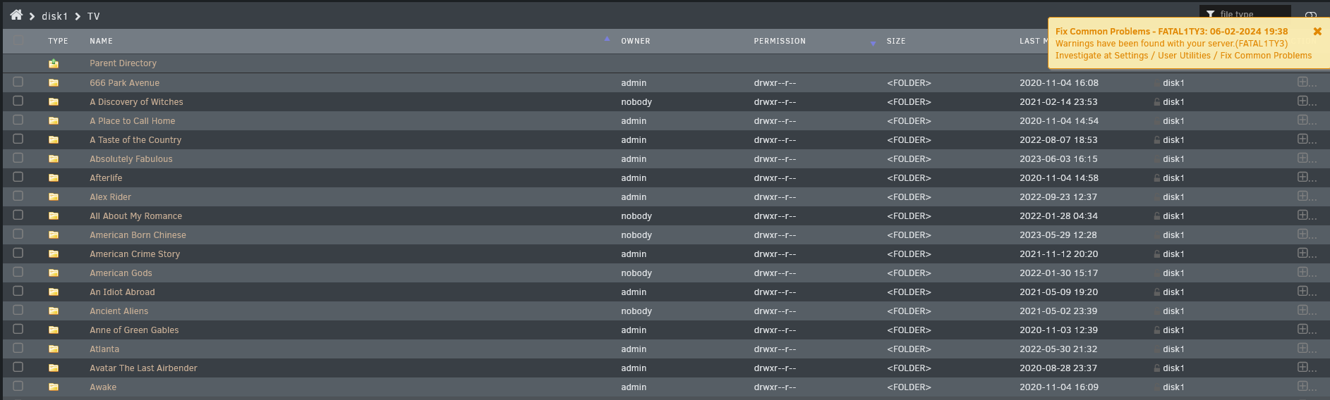

Owner and permission are quite different to other folders on the same disk
Did some further logic checking and it seems that any sub-folder with the owner of nobody doesn't show, whilst the owner of admin does. See this in the second screenshot. So I'm thinking batch change the owner and permission, but this comment here suggests just using the new permissions tool within unraid:
