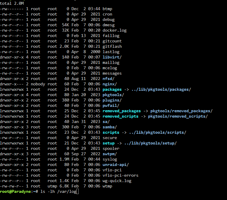

NEED HELP LOG KEEP CLIMBING UP EVEN AFTER RESTARTING

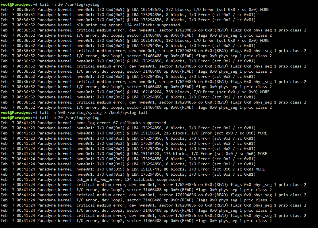

Hi, I don't know what's happening anymore. i tried googling around, some post say that my nvme broke down and etc but I can just use my docker as usual without any problem (dockers are in my nvme). I forgot where to copy diagnostics so I just screenshot all that i tried.

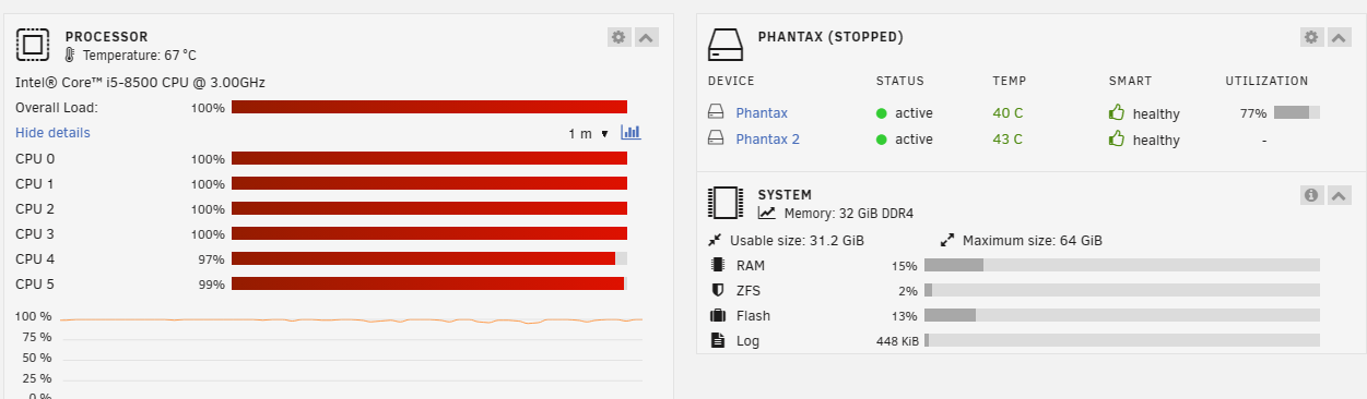

My CPU won't idle when this log happen.

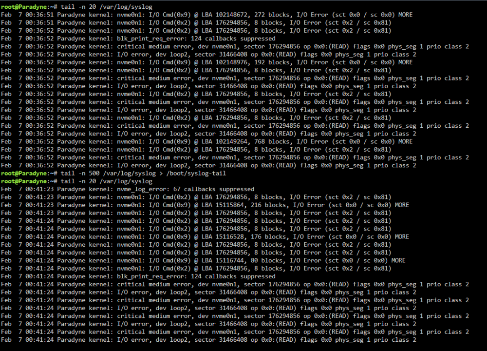

Got this from reddit and I tried it (don't know what does it say about it)
I check this every few minutes and can confirm syslog keep climbing up
Appreciate if someone can help me. Is it my docker got corrupted or my nvme broke down?

It would be better to see the diags first, but based on the screenshots it looks like a failing NVMe device.

Your syslog is full of messages along the lines of:
Feb  7 18:24:17 Paradyne kernel: critical medium error, dev nvme0n1, sector 193991280 op 0x0:(READ) flags 0x0 phys_seg 1 prio class 2
Feb  7 18:24:17 Paradyne kernel: I/O error, dev loop2, sector 33488120 op 0x0:(READ) flags 0x80700 phys_seg 5 prio class 2
where the first line suggests a problem with your nvme drive, and the second one that docker.img (which is on the nvme drive) is corrupt so any docker will probably fail.
