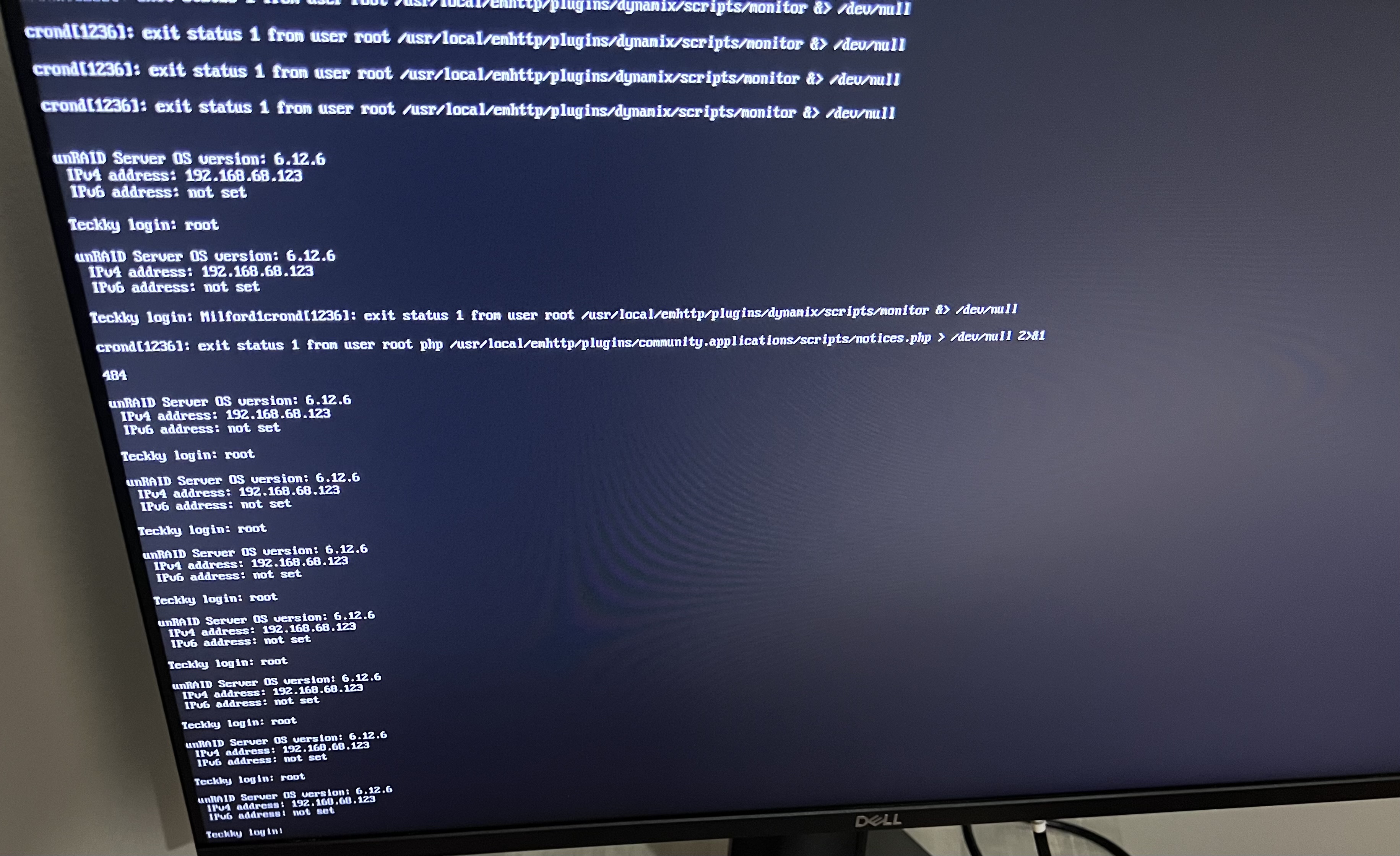

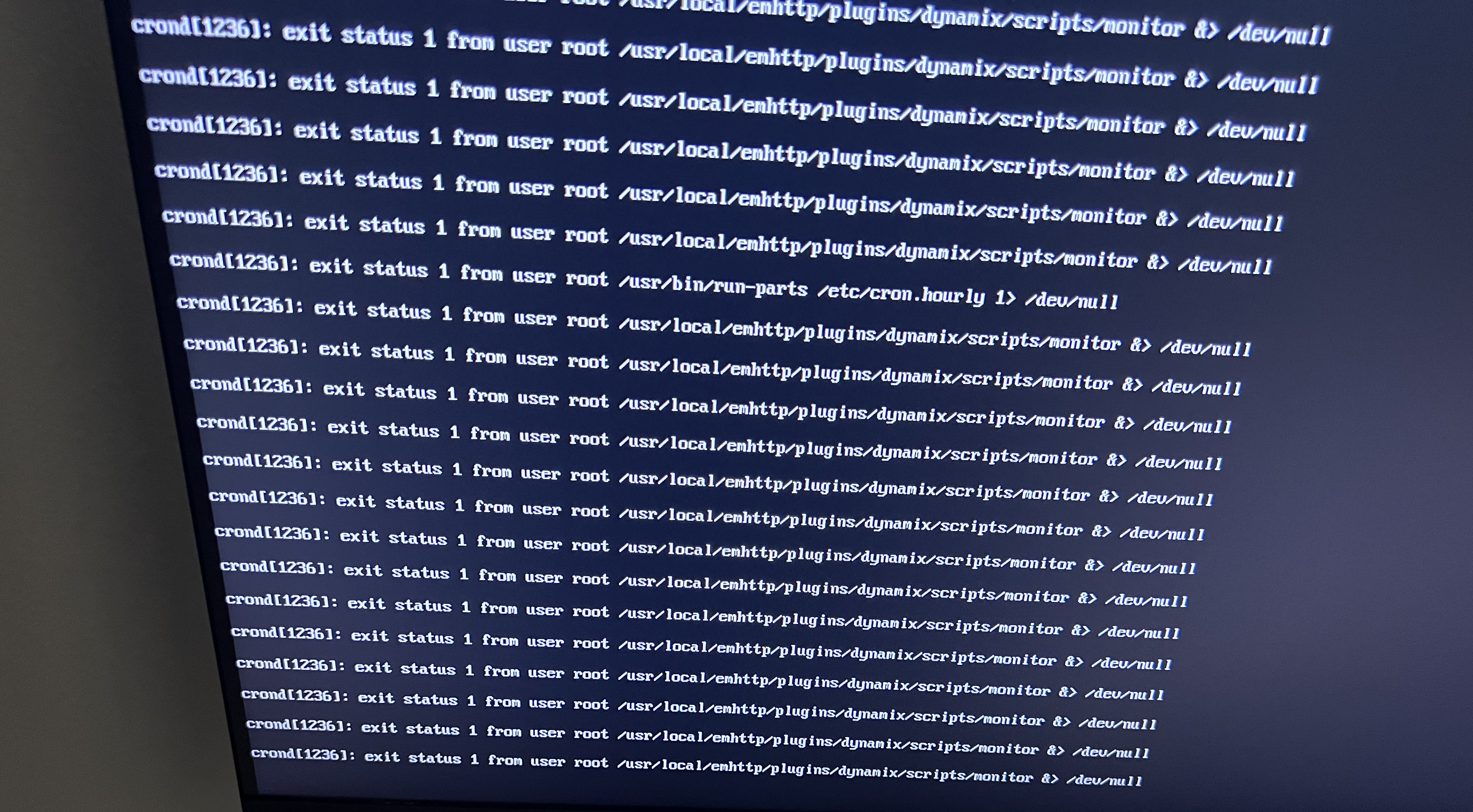

Ok this is what happens. Also, i’m unable to get the diagnostics file because I can’t get to the terminal prompt when this happens.
