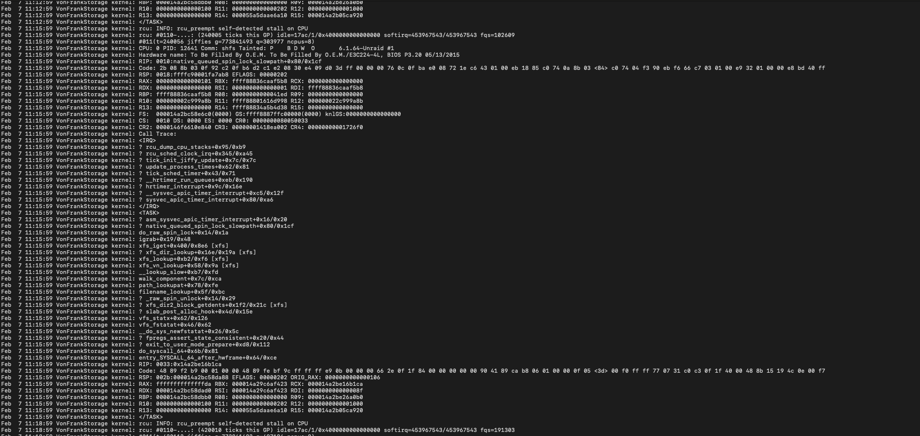

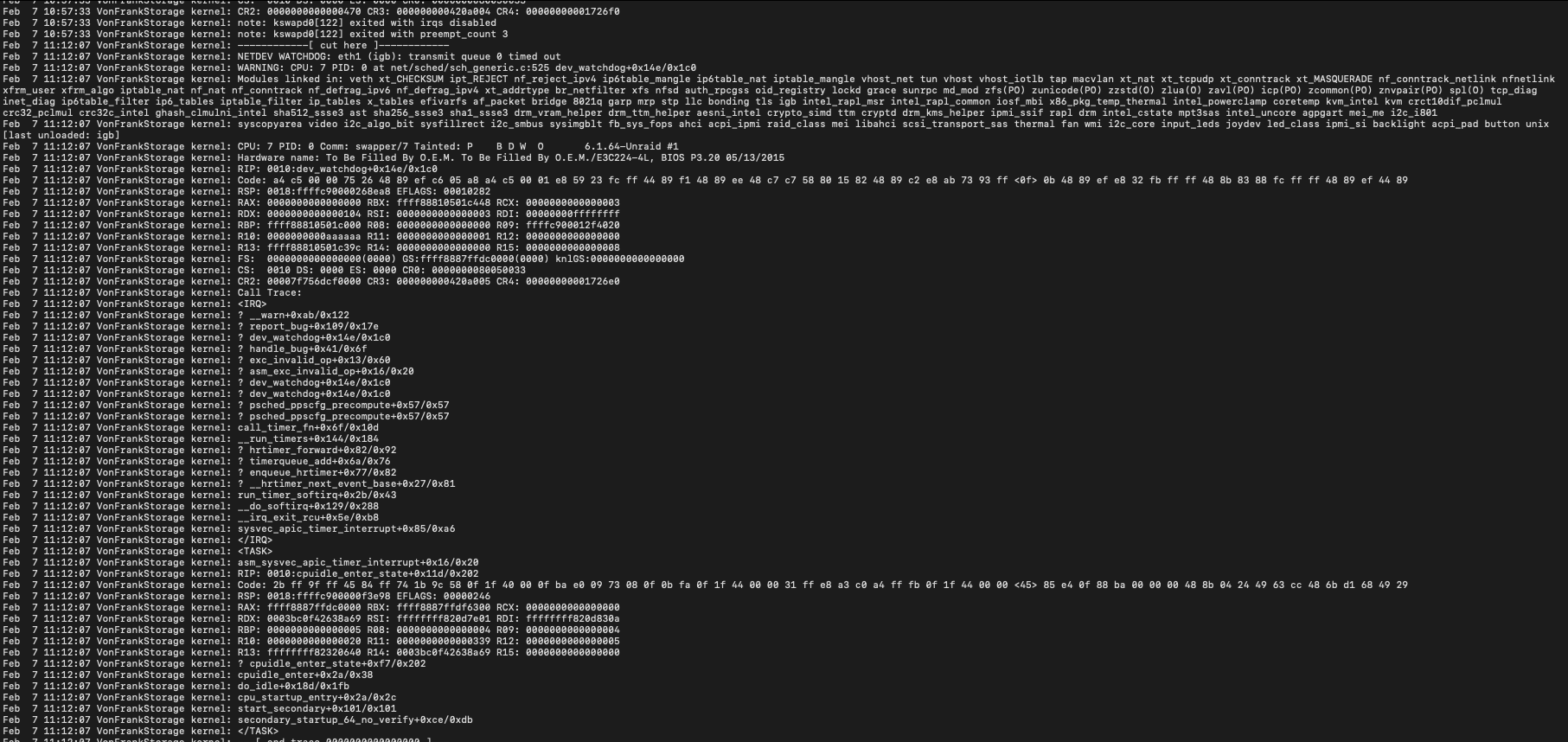

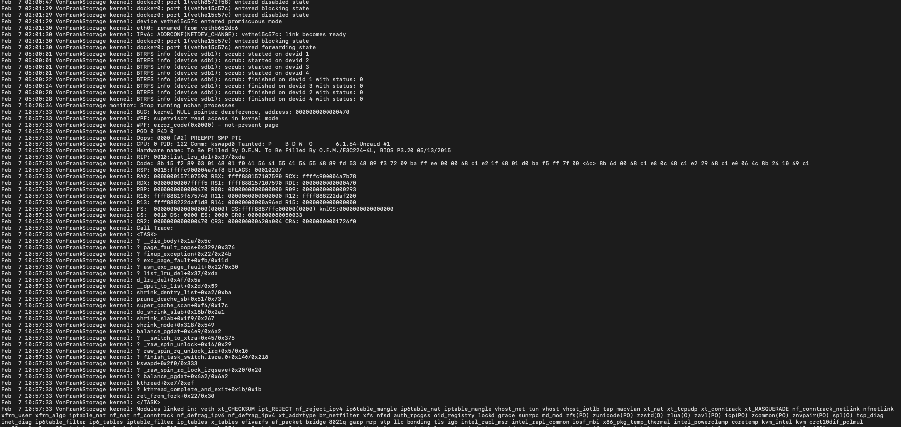

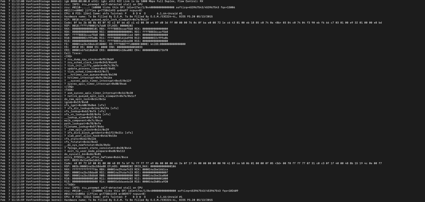

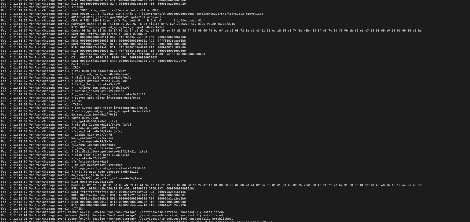

I may have a server start to die on me, and I am unable to resolve this issue. The server works fine for most of the time, but once a week/once every second week, it becomes totally unresponsive. I am not able to enter the GUI, all services running on the server dies, either containers or VMs. I started a syslog server on one of my other servers, in order to get some information, but my knowledge starts to lack when I start debugging linux. Is anyone able to see if this log seems out of the ordinary? This is what I see in the logs, up until the freeze. The time stamp 11:18:59 is before the freeze, and 11:22:01 is after a cold reboot.

Macvlan call traces will usually end up crashing the server, switching to ipvlan should fix it (Settings -> Docker Settings -> Docker custom network type -> ipvlan (advanced view must be enabled, top right)), then reboot.

That would be damn.. Is there any indication that this was the reason for this crash? And what does this mean? I did notice this in "Fix common problems" plugin, but actually suspected it to be something to do with the aggregation of NICs, but only because I didn't know better.
Very likely is since it's a kwon issue.
