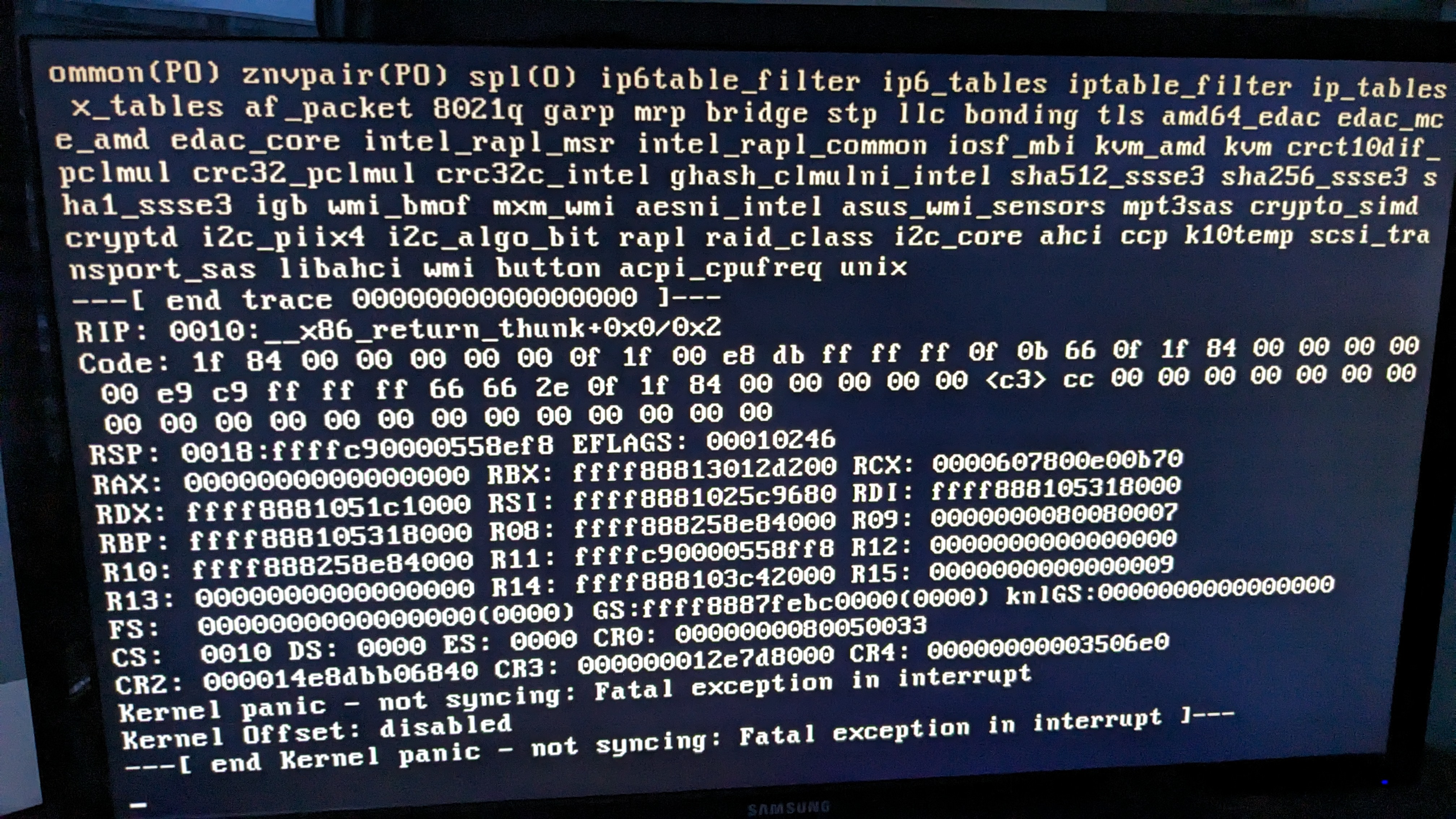

So the only thing I have for now is the following error...
Feb 8 03:30:12 Hades kernel: CPU: 12 PID: 4570 Comm: unraidd0 Tainted: P D O 6.1.64-Unraid #1
This appeared more often in the syslog

This log shows the Unraid driver crashing, this is almost always a hardware issue, suggest trying v6.11.5 just to rule a kernel incompatibility, that although rare has happened before.

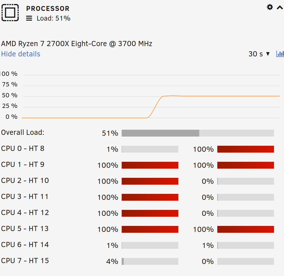

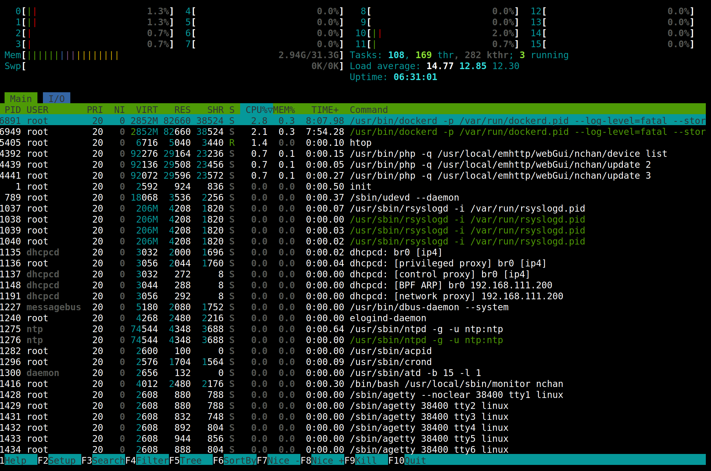

So I downgraded, and the server is not crashing, but the parity calculations is stuck (had this before with the newest version of Unraid)
It also seems like Unraid has some wrong CPU utilization information.
The syslog is a bit more interesting though...
* and I cannot turn it of (neither using the UI, nor the terminal)

Unraid driver is still crashing.
