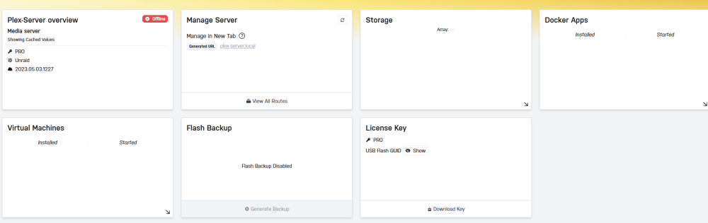

In my Unraid Dashboard all hard drives are unassigned over a 6 Hard drive array. Unraid made me set up a new admin login and password when trying to re log into the user interface to my server. The interface looks like it did when i 1st started. I also have the Pro version and its asking me for my product key. when i try to add my product key again it says "
Unable to redeem activation code for this GUID
GUID, 1609-3A04-51CE-363189217248, may already have a key or it has been blacklisted"
Can someone please tell me what happened and maybe how to go about fixing it please. I have tried to update the software and i have tried to go back to my original version and i didn't have any luck. Thank You all in advanced!
