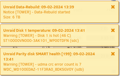

I have followed Unraid guid to rebuild the drive on to itself (seems like the disk is ok for now) There has been some warnings:Warning.PNG.b25631367fea8bfef61c0774ebed939d.PNG
I want to check what is stored on this disk and potentially remove it once the rebuild is complete.
