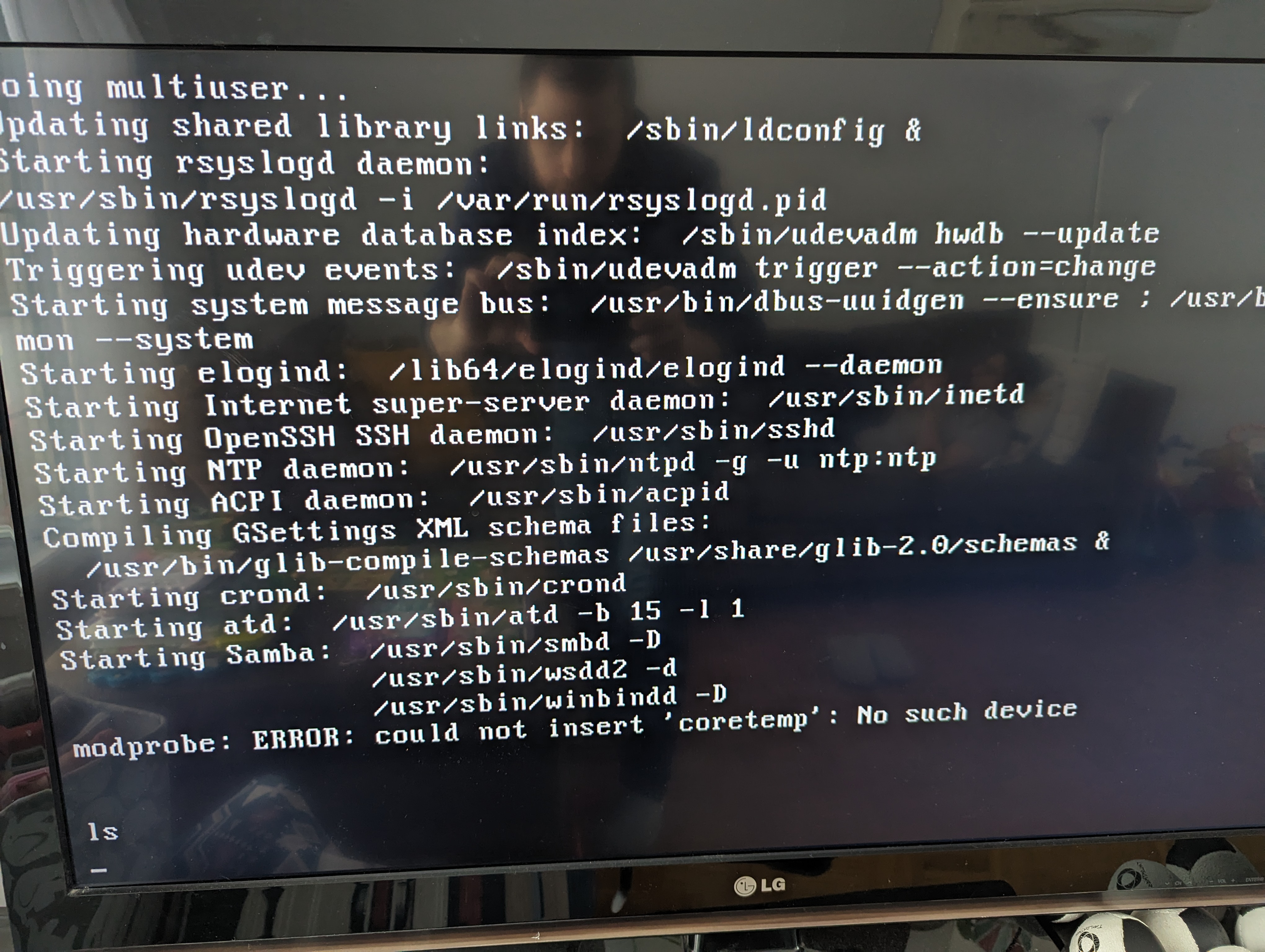

Ok I reformatted and used an old backup from November. When I boot with my USB key everything seems good to start but it stuck at this error :
modprobe: ERROR: could not insert 'coretemp': No such Device.
And its stuck, it wont boot the server.
Try booting in safe mode.
I swapped my USB key for a new one. It worked like a charm!
