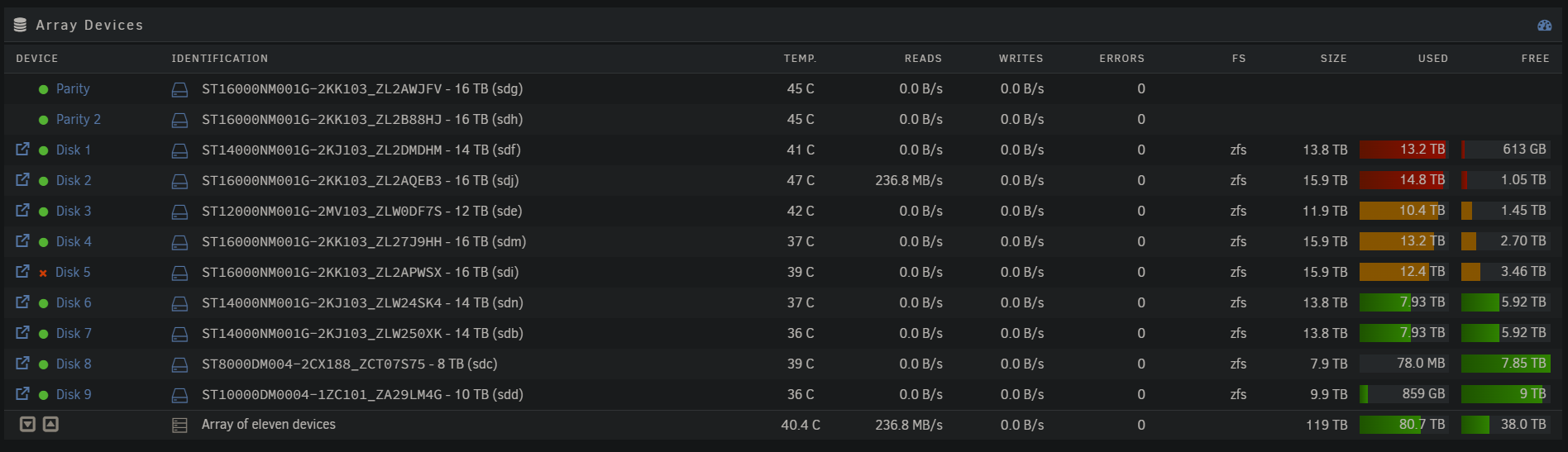

While disk 5 is rebuilding, the drive that I wanted to remove before [disk 8] has a tonne of reallocated and reported uncorrect sectors (currently 61k errors @ 6 of 16 TB rebuilt). No errors are reported on the rebuilding process. This is affecting the rebuild time substantially; which I can live with as long it gets done right. Will these bad sectors affect the files rebuilt for disk 5?

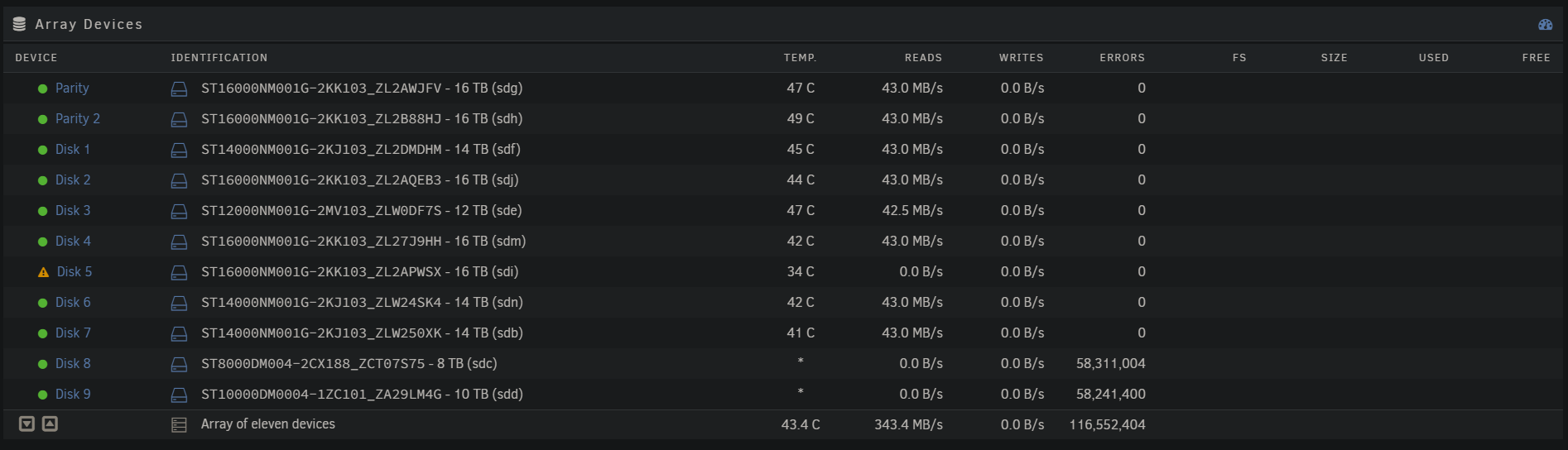

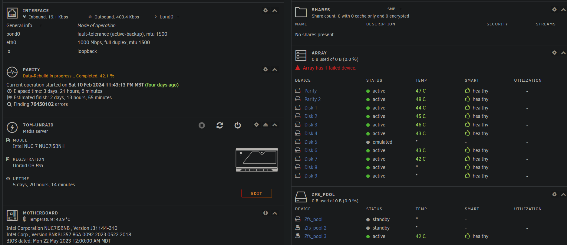

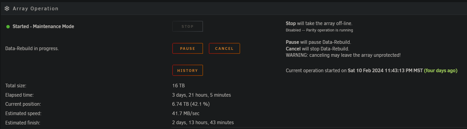

Since posting earlier, the error count has skyrocketed from 61 000 to 67 000 000 @ 6.7 of 16TB rebuilt, and now disk 9 is showing about the same as what disk 8 does. Tried to do a short SMART test via GUI on disk 9 but it won't run it. Didn't try via CLI yet. Disk 8 and 9 are in the same USB enclosure. It's an 8 bay enclosure, but only shows up as 4 paired controllers (or something like that when I had it on windows). 8 and 9 are on the same controller, even though it says in the notes: 1-1 for disk 9 and 1-8 for disk 8 (it was swapped to 1-2 when doing some troubleshooting and didn't move it back). I'm guessing that's why it's showing that, but don't know why exactly.
Also, disk 5 is now not showing any writing to it while the rebuild progresses now and is skipping along at 62MB/s, when it was usually 30MB/s before.
What would you suggest or what else can I provide for details?
