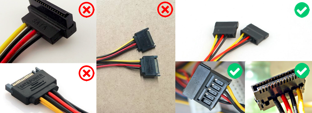

February 10, 20242 yr 2 minutes ago, SweetLogan said: I read some comments where people identified them as a fire risk Any SATA power connectors with molded plastic around the wires instead of IDC or crimped can be a hidden hazard. The 4 pin end is not vulnerable to that issue, the wire separation is huge in comparison.
February 10, 20242 yr Author 21 minutes ago, JonathanM said: Any SATA power connectors with molded plastic around the wires instead of IDC or crimped can be a hidden hazard. The 4 pin end is not vulnerable to that issue, the wire separation is huge in comparison. I've definitely been using some of the bad ones. Looks like I need new splitters, when necessary, and to make sure I evenly distribute power across the three cables I have in use. (I was incorrect saying two above) Edit to add: Thank you for the info/picture. Edited February 10, 20242 yr by SweetLogan
