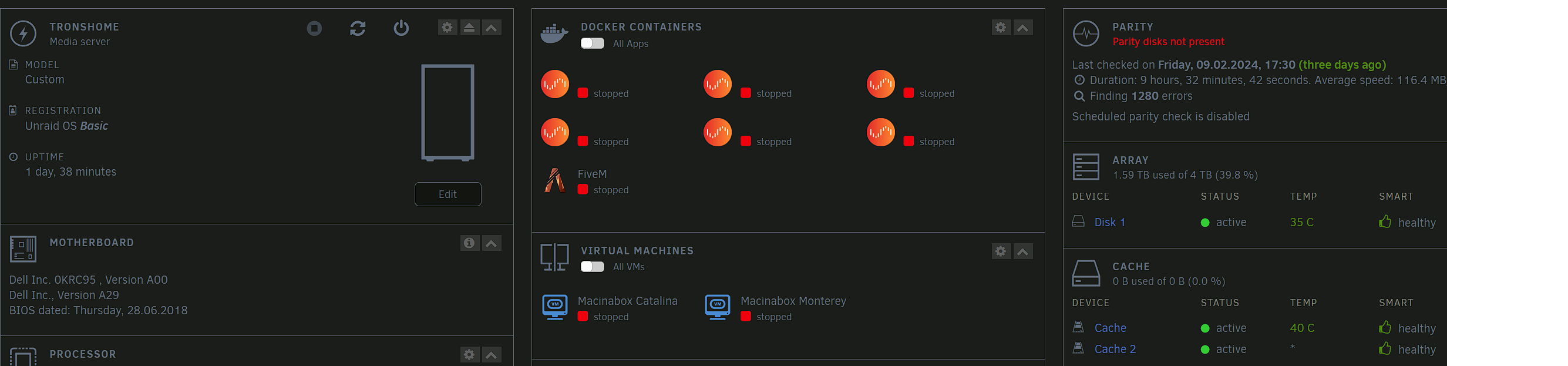

good morning Mods, a new morning with new Bugs to encounter.
This morning I first time looked at my server he showed this picture:
I tried to see if they need a Update
but that didnt solve the problem it seems that all dockerapps have lost their Icons and also thery dont work anymore...
where do i Find Logs what coudl explain the actual situation?
Thx for help on a Monday
