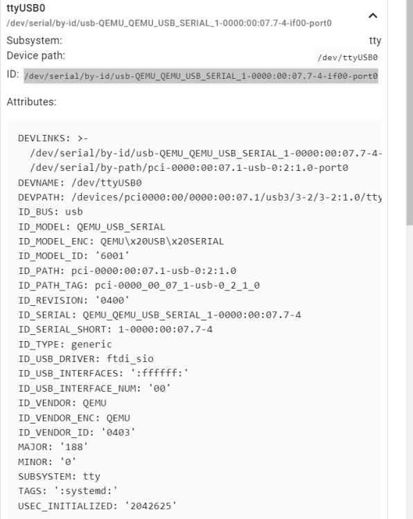

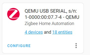

@SimonF Yes. This is the zigbee2mqtt config;
and this is in hardware section of ha

The state of the connections should be as below so looks like it is not connected as serial. Are you able to unplug and reconnect the device?
Owh man! After getting a good night rest I woke up this morning. Tried another USB port (again) and looked at the settings one more time. And then all of a sudden; my light when on. Bam!
Thank you thank you thank you!
