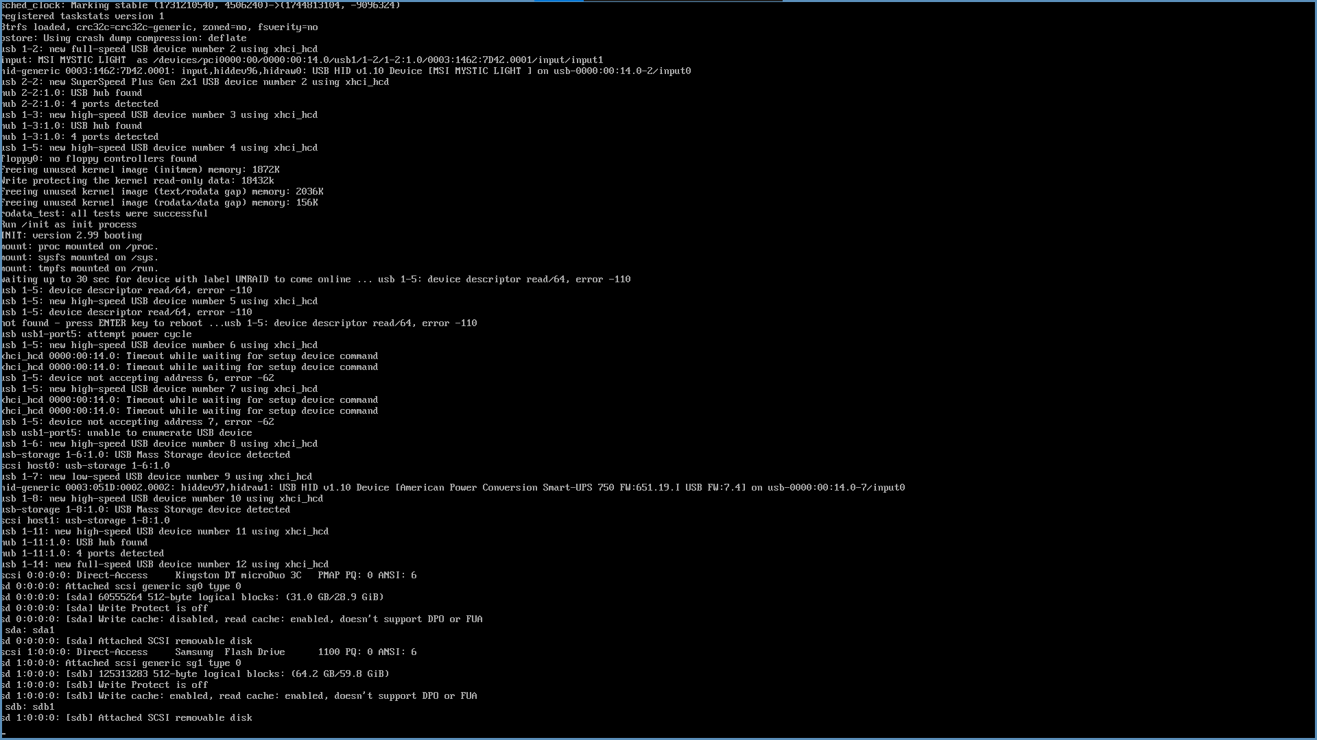

I bought a new samsung bar plus and it still gets stuck at "sdb" shown in the image

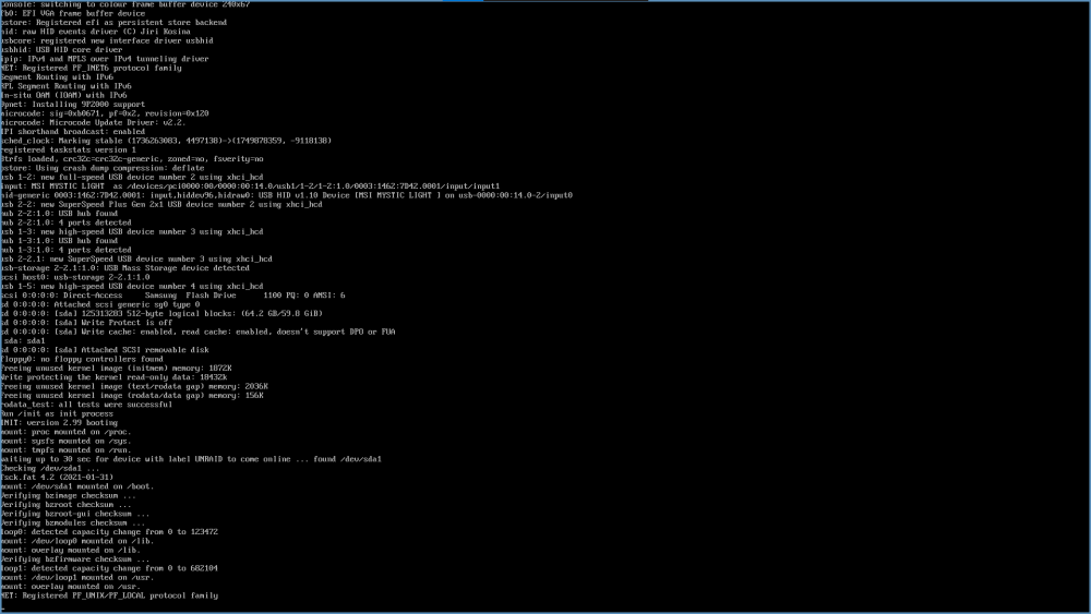

2nd reboot and all the consecutive reboots get stuck here --

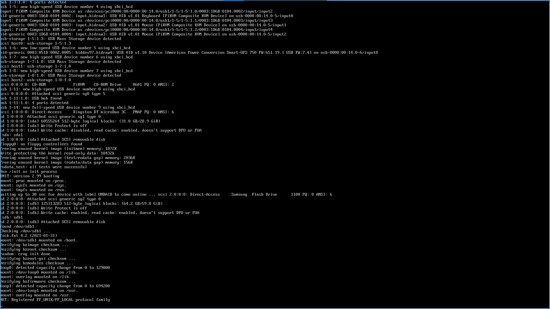

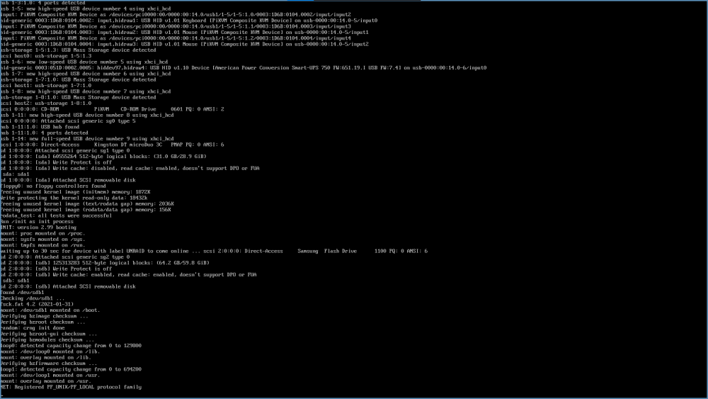

Yes!. And it also gets stuck here -- image.png.0c10b370b3c411a374a03fa52f7363
I have also tried all usb 2 and usb 3 ports on the rear side of the motherboard. It gets stuck in the same place in all the ports, so I don't think its bad ports. Additionally all other usb peripherals work fine. To make it boot into unraid Ill have to restart multiple times and be lucky that one time it may boot properly which happens rarely. Or ill have to leave the system turned off for a long duration, then come back and turn on to reboot without issues.
Also, "sdb" is my unraid flash drive, if that helps. And I dont know where "protocol family" is which is another location where it is getting stuck, like shown in the above image.

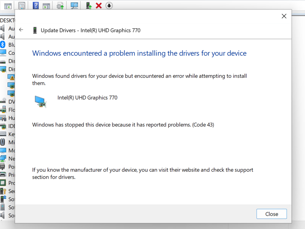

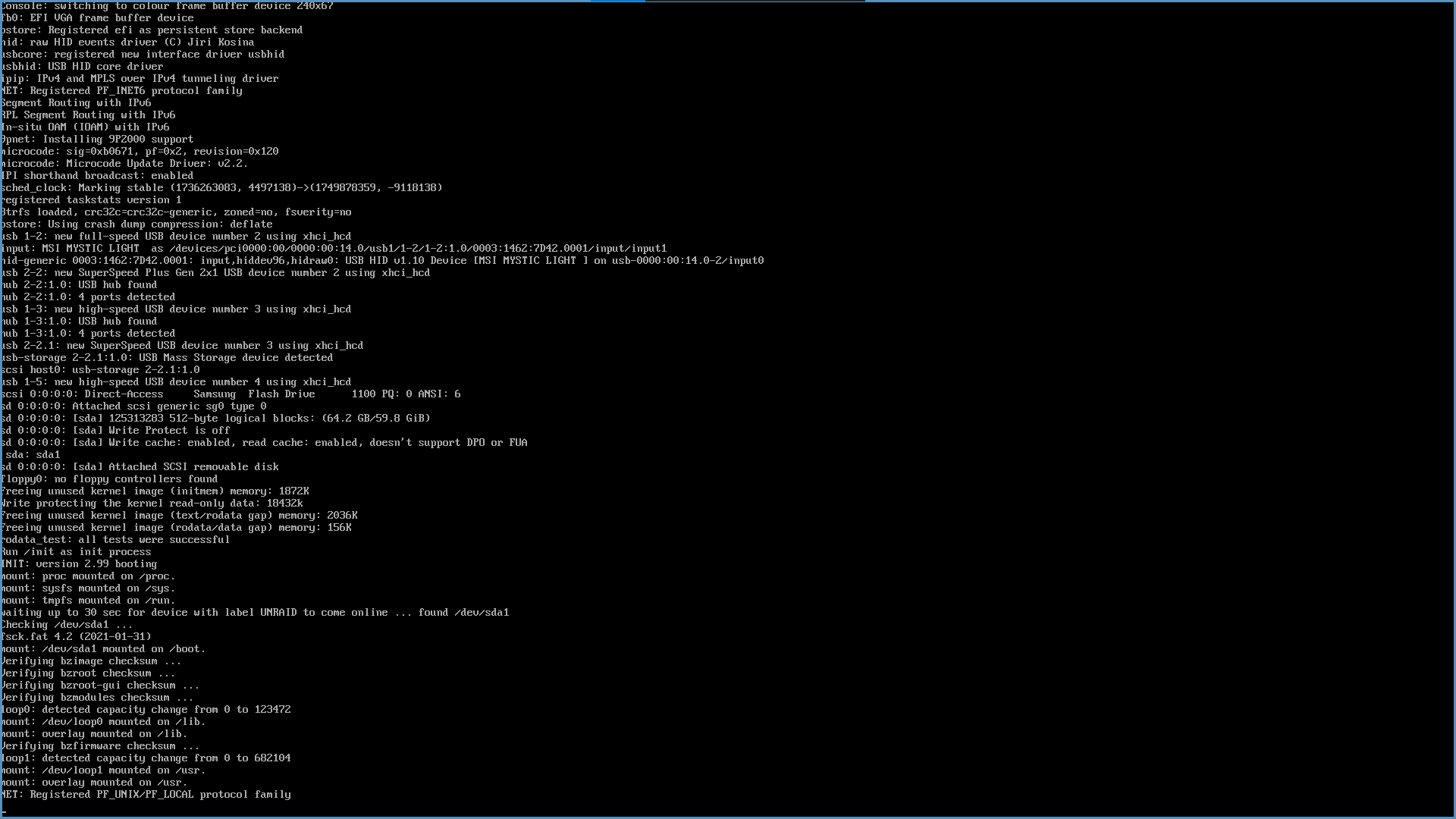

When I try to passthrough UHD770 intel igpu of i9-14900k the boot gets stuck here, I have verified this by not passing and not binding vfio for the igpu --
then in windows it shows it shows 770, the igpu but with a exclamation mark on it and when i try to install drivers, i get the error --
Any idea why this is happening and how to fix?
What board are you using? Does it have multiple GPUs? IPMI also counts.
