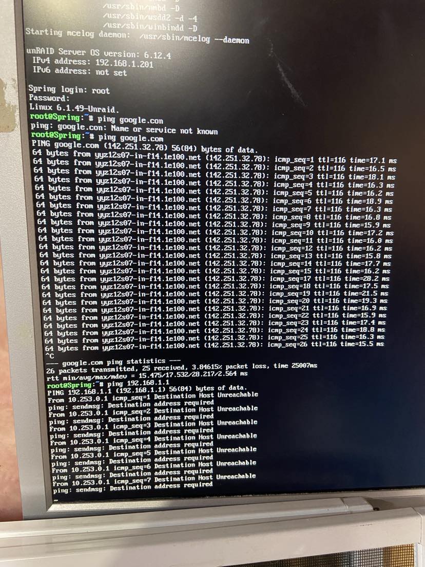

- From the server, I can ping Google but not other devices on the network or the gateway (shows "destination host unreachable ping: sendmsg: destination address required"). I cannot ping the server from other devices on the network either.

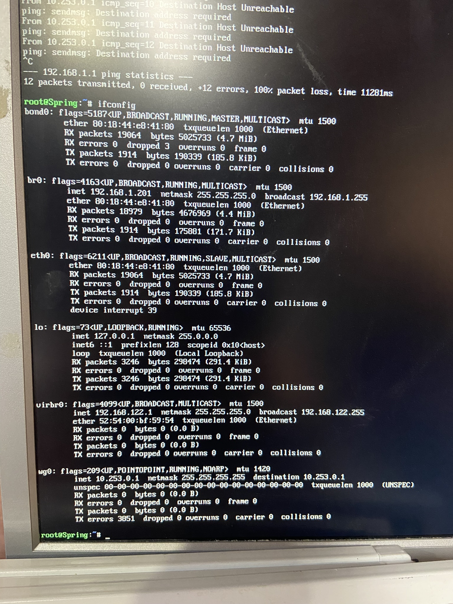

- ifconfig does not show an IP address assigned to eth0, my static address is assigned to br0. I never looked in here before so I can't say if this is unusual or not.

I feel like eth0 should have an IP here? The server's static IP should be 192.168.1.201.
Tried, no luck:

Also tried unassigning the static IP mapping on my router, just to definitely rule out a conflict. The DHCP gave it a new address but same result, no connection, so reverted that change. I still think it's odd I can't ping the router/gateway from the server:
421242862_377701538210882_5412092871721688864_n.thumb.jpg.f91b6130747d8e4193b79ab7a2583cd5.jpg

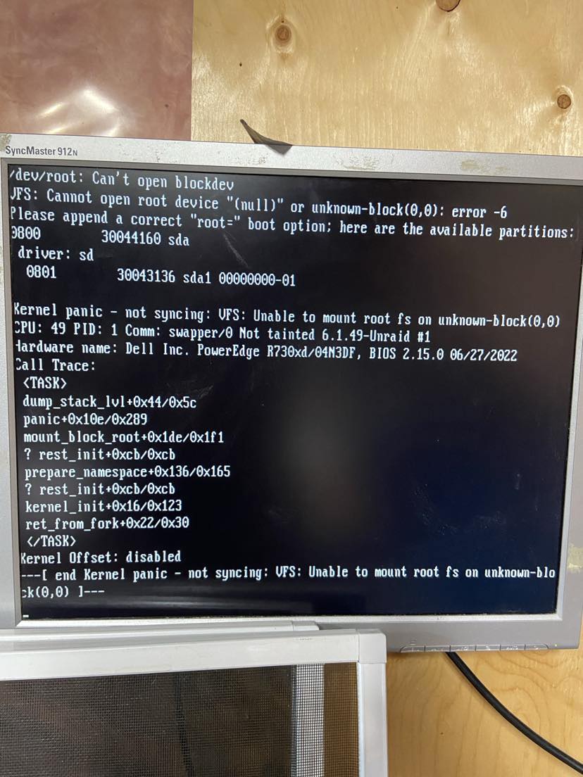

  • Booted as a test. Got a kernel panic (image below).
  • Rrepeated with a 2nd USB drive, so there coudl be something funky with 6.12.4
  • Repeated all above using 6.12.6, this time it booted successfully.

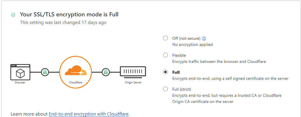

I am not sure. I had been having problems with connecting remotely with WireGuard for the last year. The issues were limited to connecting iOS devices. I fixed the issue for a time (there is a thread on this somewhere) by updating this setting in CloudFlare (my DNS+CA the VPN uses):
But this broke again a month or so later. The most recent config change I made in order to fix the iOS issue was to change the Access Type on a number of the peers. That was a few weeks ago. I probably had not rebooted since.
