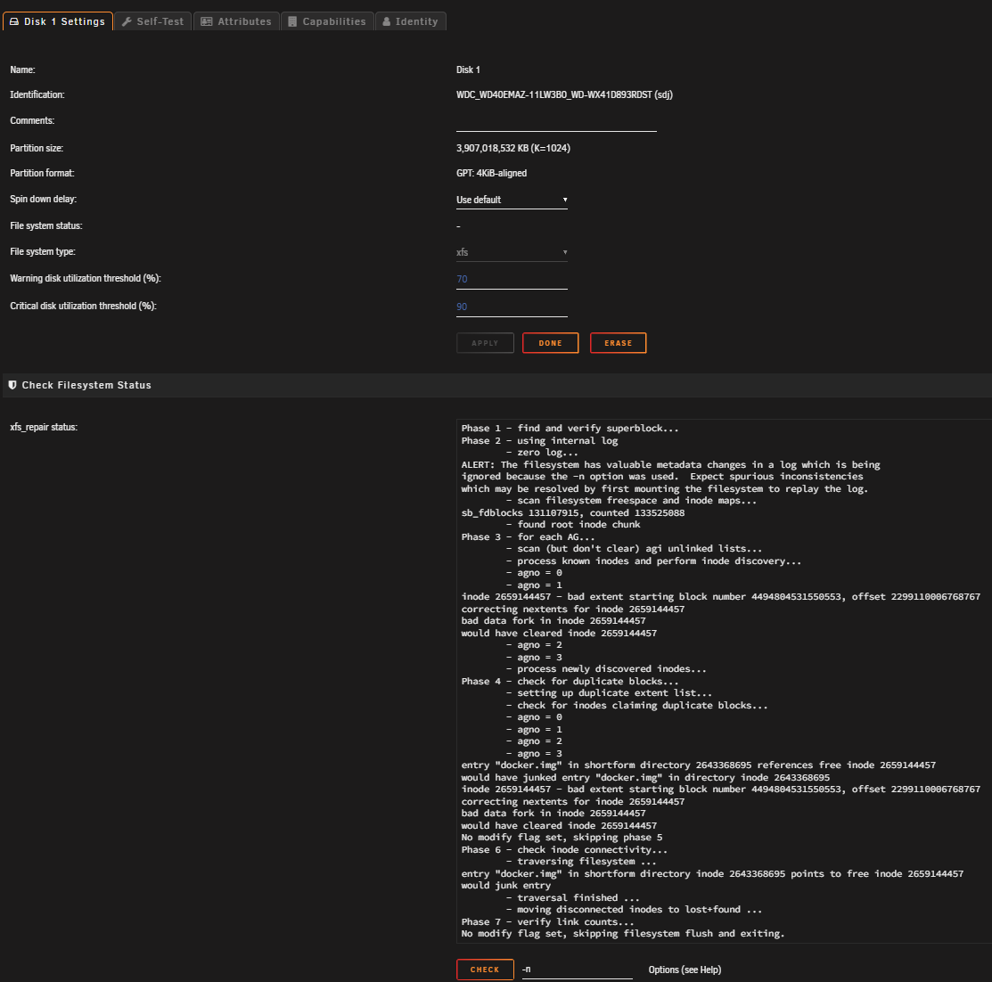

Check filesystem on disk1. Be sure to use the webUI and not the command line. Capture the output and post it.
Is this what your referring to?
Yes.
Do it again, without -n. If it ask for it, use -L
Would be better to copy/paste the text of the output instead of screenshot.
Okay, Will do and not a problem just wanted to make sure it was the right info.
