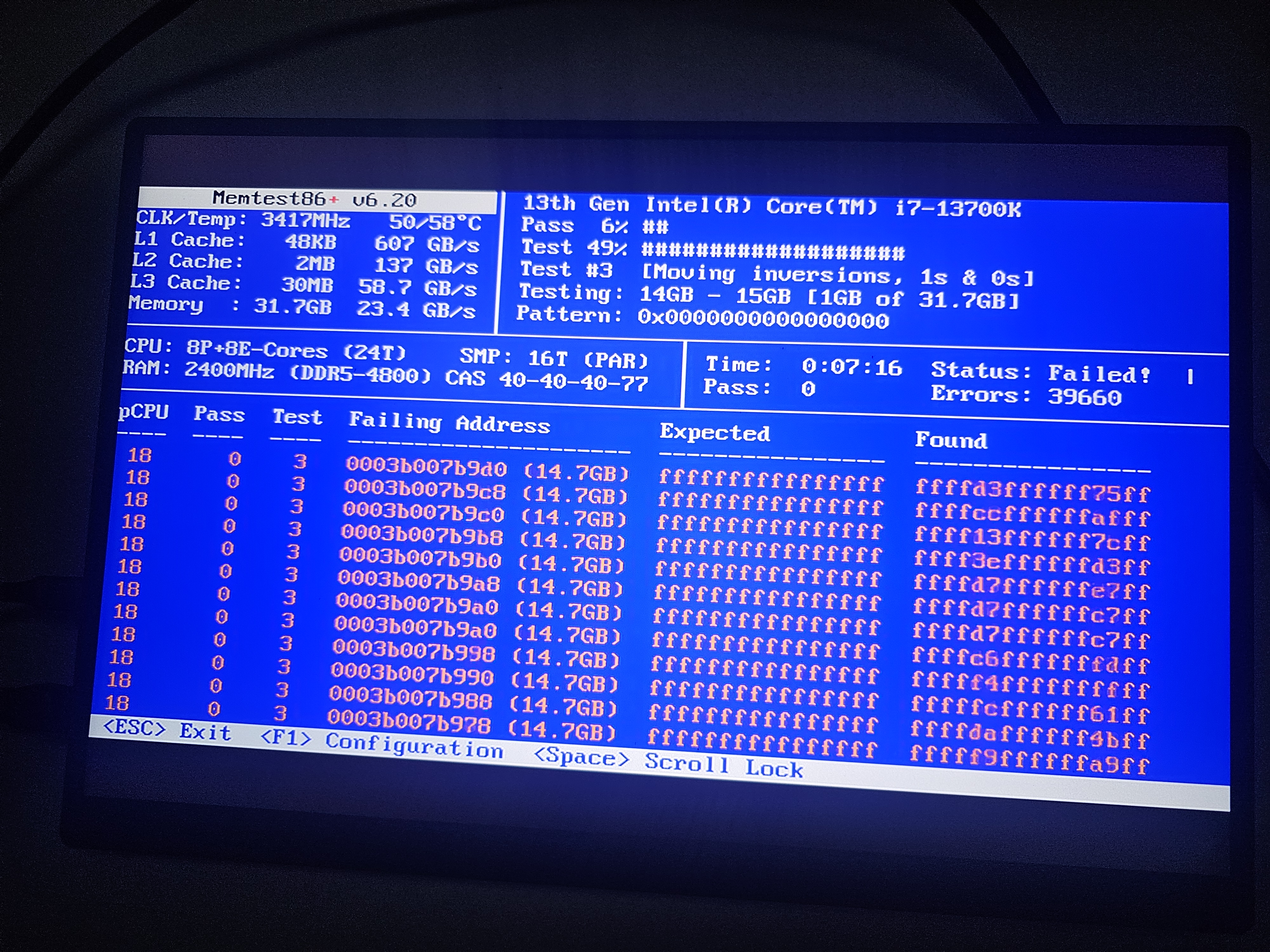

Ok so I've been trying to make it crash since yesterday, and (thankfully?) it hasn't happened since. My guess is that disabling XMP fixed the stability issues. What is still occasionally happening is corrupt data on the cache drive, which could be faulty RAM, so I'll still run memtest just to be sure, then come back with results here.
@JorgeB I guess that settles the root cause? Been running for 8 min and all I see is red
Yes - even 1 error in memtest is too many and once you have memory errors the symptoms can be unpredictable.
If you have more than 1 stick of RAM then you might try testing them individually.  It is, however, not unheard of for them to test out individually but still fail when they are all plugged in - typically due then to the memory controller being overloaded.
Yep, that makes sense. I'm running a full set of tests, both individually and together. My suspicion is actually the motherboard slots, because they were failing individually on those slots, but changing them (so far) yielded no errors. I'll keep this thread open for a while longer in case something else happens, but I'm 99% sure the problems I was having were due to xmp + faulty ram.

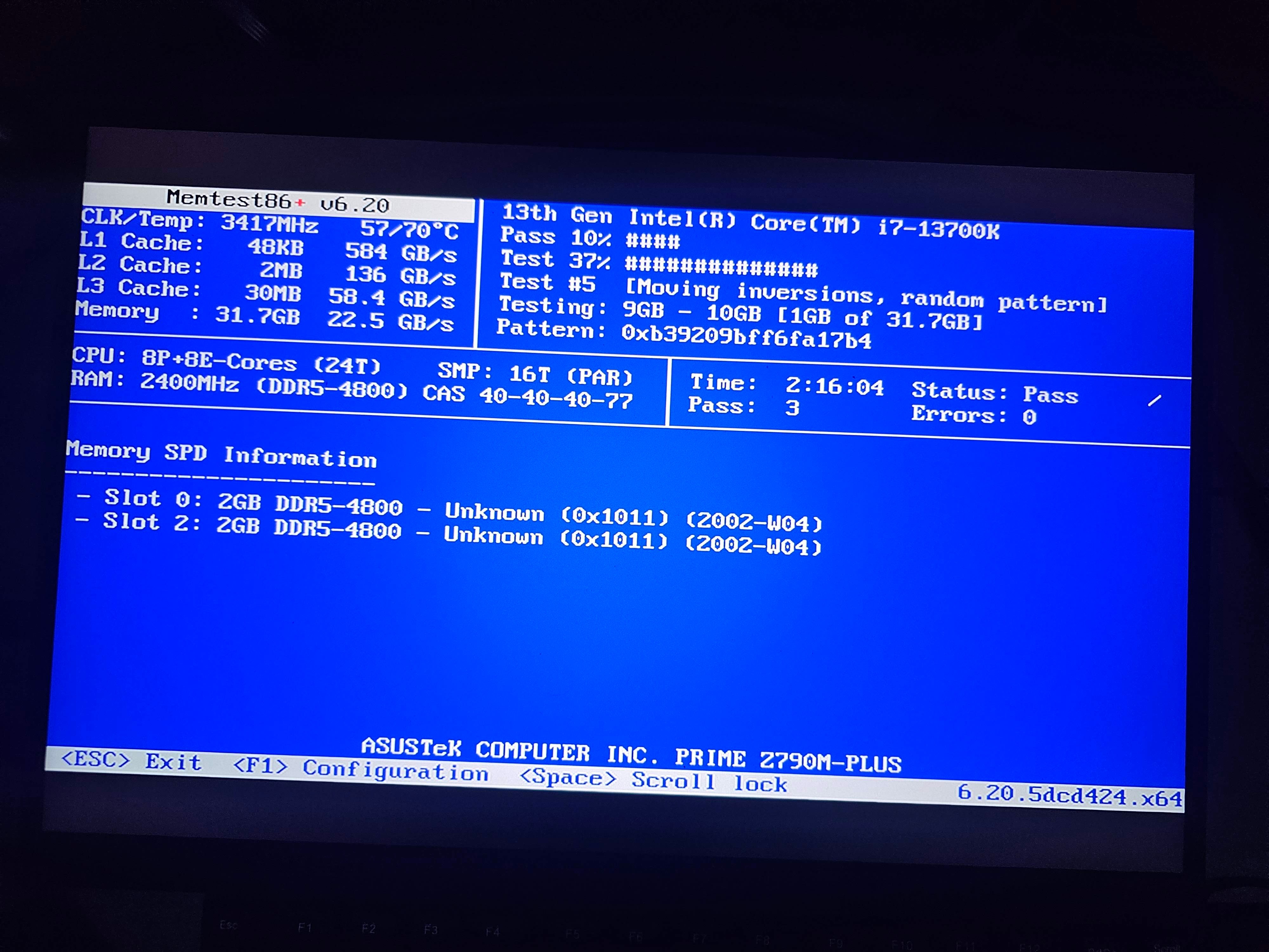

Ok so a couple of things happened:
  • I cleaned up my ram sticks / slots and it seems to be passing on memtest now. I'll still do a longer 24hr+ test, but at least I'm hopeful that this is no longer the issue

You may still have a RAM issue, try with just one stick of RAM installed, if the same try a different one.
@JorgeB I did some extended testing throughout the weekend and the system was pretty stable with either ram sticks, but starts to be unstable when using both (although I did see docker crash once using a single stick). Is there a correlation with what itimpi mentioned about the memory controller being overloaded, maybe? Did I just win myself a 16gb ddr5 paperweight? (the memory is running at 4800MHz if that influences anything)

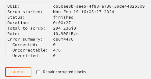

On another note, should I also worry about these errors on my cache drive?
Thanks again for all the help!
It's possible, dual channel increases the load on the memory controller, and could be much worse if the two DIMMs are in the same channel, or with 4 DIMMs.
I assume there's not much that can be done in this case, then?
Also, is it fine to leave the cache drive with those errors?
Thanks!
You could try different RAM or a different board.
Look in the syslog after a scrub, it should list the corrupt files, delete those or restore from a backup.
