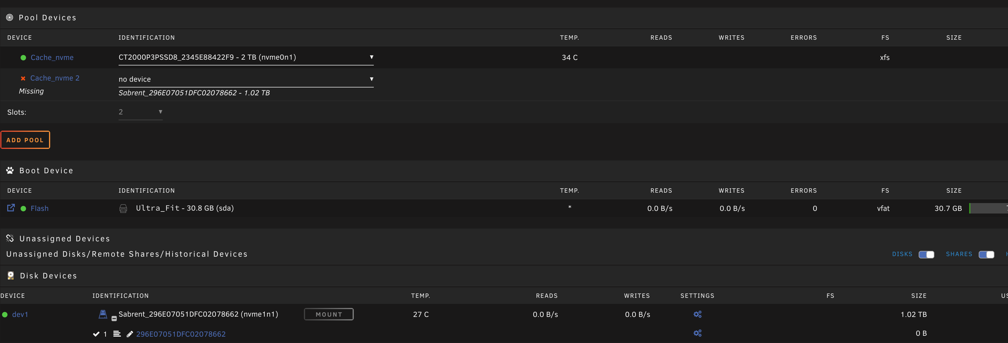

So I may have screwed up. I have one nvme ssd as my cache pool, all appdata / appdata backup / etc is there. I wanted to add a second nvme ssd into the pool. So naively, I took the array offline and just added the new nvme and it showed it's unmountable as seen below:
So I took it down and now I can't remove the second nvme from the pool. It always shows as missing.

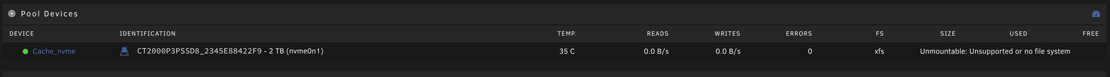

I did and it's still unmountable even though it wasn't formatted at all?!
475364659_CleanShot2024-02-13at15_39.01@2x.thumb.png.f08a423b9d06c7a9c06fe1630db07011.png
Did I just lose all my appdata? :S I do have one appdata backup thankfully. But is there a way to actually recover it manually?!

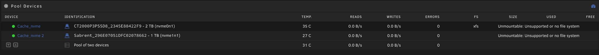

Just to reiterate. I added the second ssd drive and started the array and it showed it wasnt mountable as it shows now even with just the initial one. No formats were done to the first / original drive.

You might need to check that Unraid still thinbs the drive is xfs format as it might have auto-changed it to be btrfs format when you changed it to be multi-drive.   If that is the case clicking on the drive (with array stopped) and changing format to explicitly be xfs may be required.
That was my first reaction, until I expanded the first attached picture. It clearly shows a 2 device pool with XFS as the format. I'd classify that as a bug.
