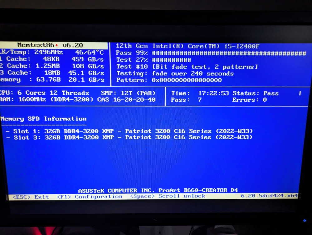

There are several call traces logged, but difficult to say what causing them, you can try running memtest and/or boot the server in safe mode with all docker/VMs disabled, let it run as a basic NAS for a few days, if it still crashes it's likely a hardware problem, if it doesn't start turning on the other services one by one.

Not really, and still crashing while running as a NAS makes me suspect hardware, try running with just one stick of RAM, if the same try the other one, memtest is only definitive if it finds errors.
I removed one RAM stick and it was successfully able to complete a parity check with all the services on -- which it has never been able to complete before -- so I think it's fixed (unless I post again in a few weeks). Thanks Jorge for your help!
