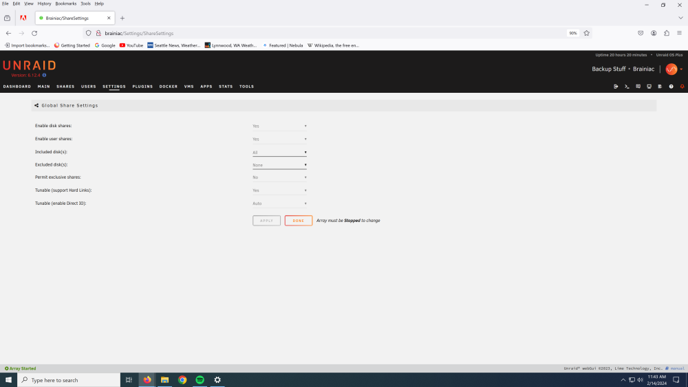

Hello, i seem to forgot how to populate a share to the disk location. I checked a lot of youtube videos but no one in there adds the data.

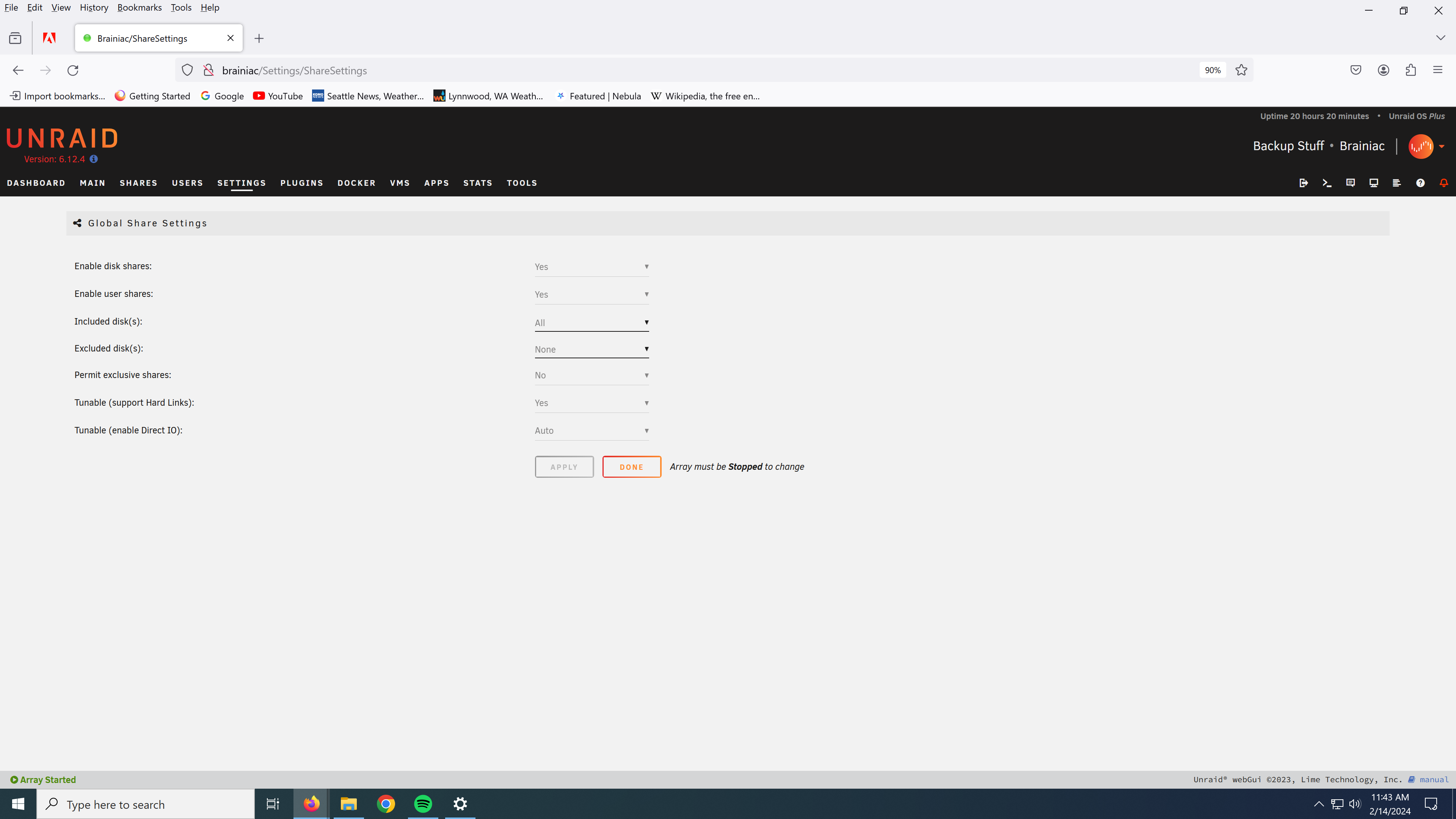

Global settings
enable disk shares    yes
enable user shares   yes
included disks          all
exluded  disk           none
Permit exclusive shares no
tuneable                Yes
tuneable   direct io  auto

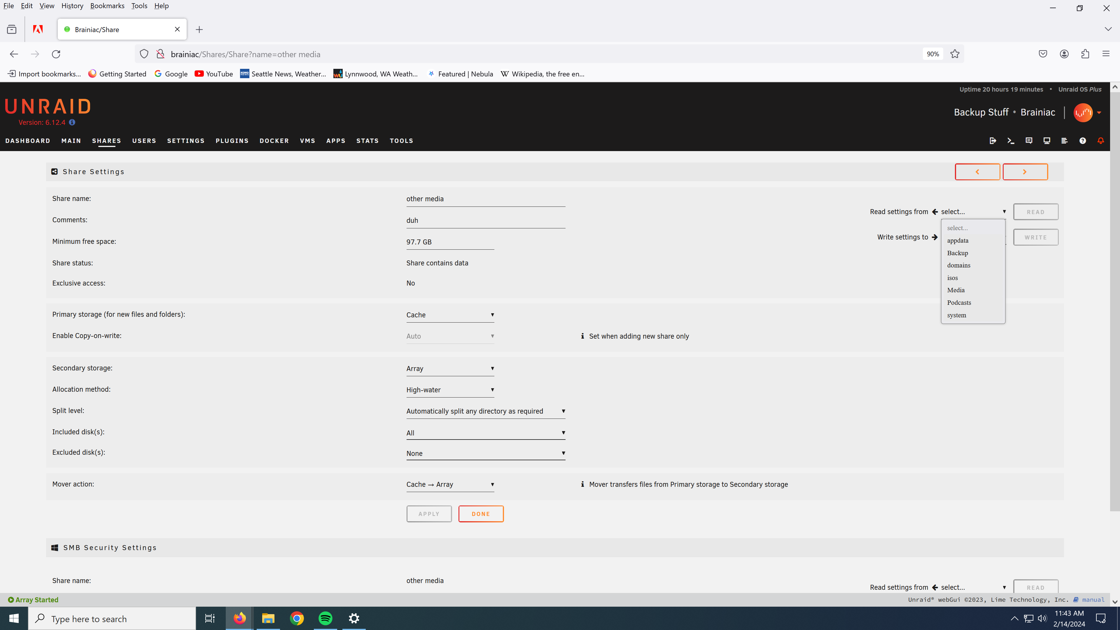

When i try to set it in the shares tab the drop downs on read write only shows the other shares.
Maybe a screenshot would clarify.

What i want to do is put the files that are not in other shares. Like the first time you make a share
and yes i had to remind my self how to do srceenshots.
Edited by curving-stepladder2787
Please close irrelevant windows when you get screenshots. Even better if you figure out how to get a screenshot that only includes the important part of the screen instead of everything on your monitor.

I thought it was the read write buttons. The read section, only has the arrow box which only shows my existing shares
The read and write buttons are greyed out even on the shares i have
