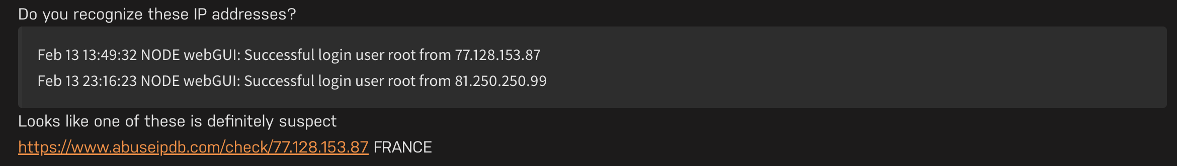

Do you recognize these IP addresses?
Feb 13 13:49:32 NODE webGUI: Successful login user root from 77.128.153.87
Feb 13 23:16:23 NODE webGUI: Successful login user root from 81.250.250.99
Looks like one of these is definitely suspect
https://www.abuseipdb.com/check/77.128.153.87 FRANCE

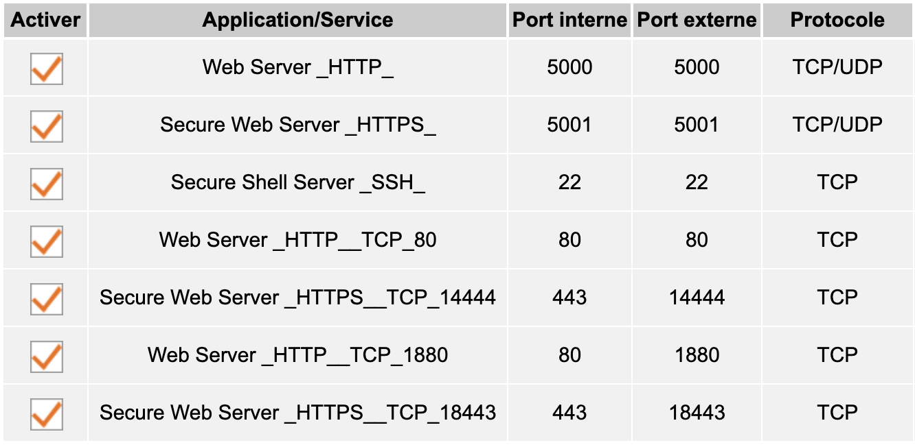

I've checked the configuration done in my router and here are the redirections regsrding the ports :image.thumb.png.7707b1b70685950f13ad94486eca64b7.png
I'm not very knowledgeable about networks and redirections but after reading the document mentioned above I don't think my NAS is connected to the internet.
Please let me know if you think the setup is wrong.
If the problem is not external, what can explain these permanent disk accesses which are not seen in the disk activities page on the user interface and which occur even when the array is stopped ?
Thank you once again for any help you can give me.
if
"secure Shell Server _SSH_"
"Web Server _HTTP__TCP_80"
and to some extent
"Web Server _HTTP__TCP_1880"
"Secure Web Server _HTTPS__TCP_1444"
"Secure Web Server _HTTPS__TCP_18443"
link to your computer thats running unraid, you exposed it to the internet with a fancy invitation letter.
OK, not a good news...
As previously said, I'm not knowledgeable on this point : what is your suggestion ?
The redirections regarding the Secure Web Server (Secure Web Server _HTTPS__TCP_14444) is not needed for Unraid Connect ?
I really appreciate any advice or any changes to make to secure my connection but also to understand why one of the disks (or several) has these accesses which I cannot explain.

I've now deactived all the redirections, except the one for Unraid access.
i'm pretty sure that i've not been hacked because even if the redirection configuration was awful, i have a stroing password on the serevr and most of my share are in private mode.
