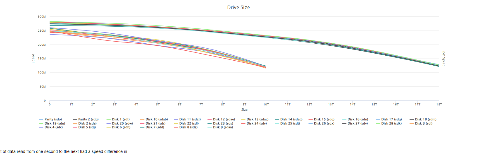

Update,
I've narrowed the issue with my parity check speed down to 4 drives all connected to the same port on my sas expander (Adaptec AEC 82885t). I removed these 4 drives from the array and speeds are back to normal. After digging through the syslog file I noticed a bunch of "power-on or device reset"" all coming from these same 4 drives. This expander has a total of 19 drives connected directly to it and another expander daisy chained with 8 additional drives. Is this too much for the expander? Heating issue? I've already replaced the breakout cabled 3 times and it has not resolved. Since the 4 drives have been removed not a single error.
