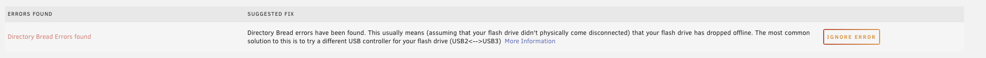

About a week ago I noticed I was getting this alert (see attached) which suggested an issue with my boot flash drive.
